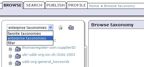

On this page, you can use the drop down list to switch the taxonomy list to favorite taxonomies, enterprise taxonomies, and a defined filter.

Switch the drop down list shown in Figure 54 to the filter option.

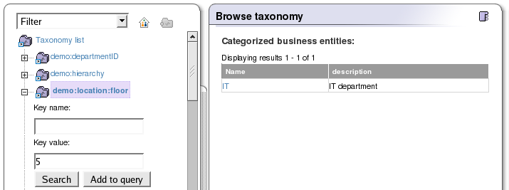

Click on the demo:location:floor taxonomy. Expand the taxonomy by clicking on the plus sign in front of the taxonomy name. The key name and key value field pair appears.
Enter key value as 5, then click Search button.
You will get a list of UDDI entities categorized by this taxonomy with matching key value (IT in this case) as shown in Figure 55.

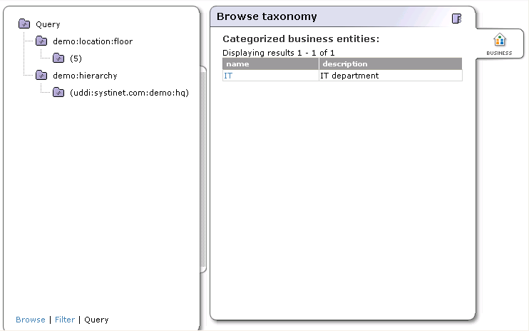

You can also combine search criteria in a query. To add a search criterion to a query, use the button Add to query shown in Figure 55. Then, you can expand another taxonomy and specify a new criterion. The page shown at Figure 57 presents the query displaying business entities located on the 5th floor (demo:location:floor taxonomy) having Headquarter department as the superior department (demo:hierarchy taxonomy).
To remove a category from the query, right-click on the query and select remove from query from the context menu.
