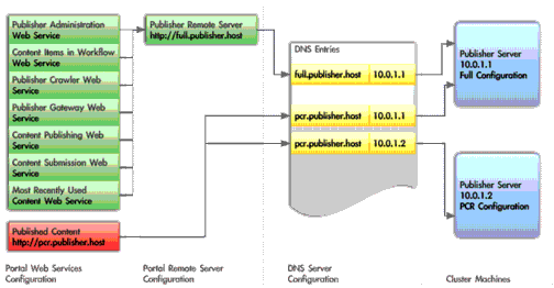

Figure C-1 gives an overview of the highly available published content configuration. This configuration uses clustering, which involves mapping of multiple IP addresses to a single machine domain name, sometimes referred to as the ‘virtual host’ (see ‘pcr.publisher.host’ in Figure C-1).
Figure C-1 High-Availability Published Content Configuration
