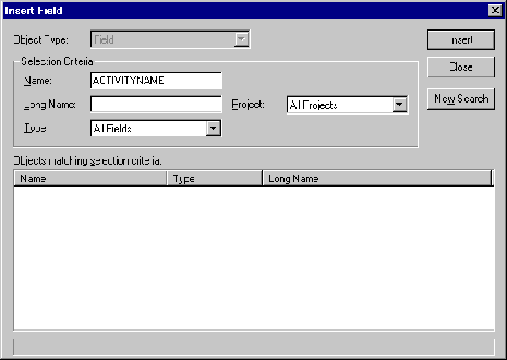

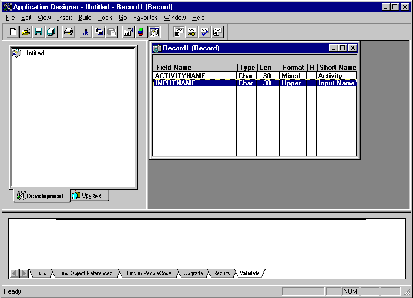

Add Fields To The Record Definition
Change the Name field from ACTIVITYNAME to INPUTNAME and click Insert. Figure 2-3 shows how the Record Definition displays with both fields.
Figure 2-3 View of record after inserting the required records.

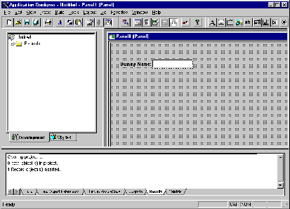

When using PeopleTools, a panel must be defined to allow access to the ACTIVITYNAME and INPUTNAME fields defined in the BEA_CPS record. Select File->New and highlight Panel in the New dialog to create a new panel. Select OK (Figure 2-8).
Figure 2-8 Create a new panel definition.

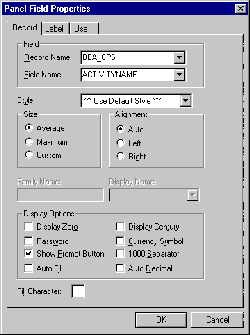

Adding fields consists of adding two edit boxes and defining the properties of each.
Figure 2-9 Add the first text entry field to the panel.
Figure 2-10 Set the panel field properties for the ACTIVITYNAME field.

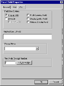

Figure 2-11 Set the panel field properties for ACTIVITYNAME to display only.

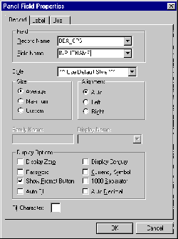

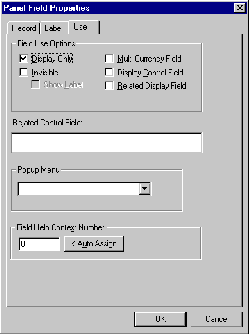

Following the same method used for the ACTIVITYNAME, add a second entry field for INPUTNAME. Place this entry field in the center of the bottom half of the panel window. Select Insert -> Edit Box from the menu (pointer changes to crosshair), position the crosshair in the center of the lower half of the panel window and click on the panel window, double click on the new entry field to bring up the Panel Field Properties dialog. For the Record Name specify BEA_CPS. For the Field Name specify INPUTNAME (Figure 2-12). Under the Use tab check Display Only in the Field Use Options section (Figure 2-13). Select OK.
Figure 2-12 Define the panel field properties for the INPUTNAME field.
Figure 2-13 Set the panel field properties for INPUTNAME to display only.

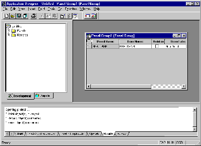

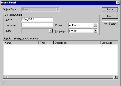

From the menu select Insert -> Panel into Group to bring up the Insert Panel dialog. Specify BEA_PANEL in the Name field and press the Insert button (Figure 2-16). Select Close to close the Insert Panel dialog (Figure 2-17).
Figure 2-16 Insert the BEA_PANEL into the panel group.
Figure 2-17 The panel group with BEA_PANEL inserted.

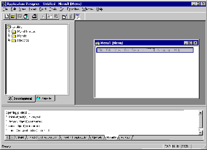

To create the menu select File -> New from the menu and select Menu from the New dialog. Select OK.
Choose Standard as the Menu type and select OK (Figure 2-20).
This will display a menu window with the new menu in it. In the menu, between Favorites and Language, is an empty space outlined with a dashed rectangle (Figure 2-21). Double click within this rectangle to bring up the Bar Item Properties dialog.
Type BEA in the Name field and eLink for PeopleSoft in the Label field (Figure 2-22).
Select OK.
Figure 2-20 Create a new standard menu.
Figure 2-21 The newly created menu.

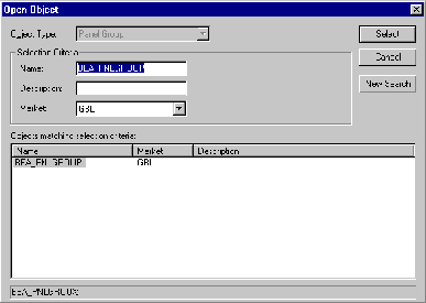

The panel group created previously is added to the menu by pressing the Select button on the Menu Item Properties dialog. Press the Select button to bring up the Open Object dialog. Specify BEA_PNLGROUP as the Name (Figure 2-24). Press the Select button in the Open Object dialog to return to the Menu Item Properties dialog. Select OK in the Menu Item Properties dialog.
Figure 2-24 Add BEA_PNLGROUP to eLink for PeopleSoft.

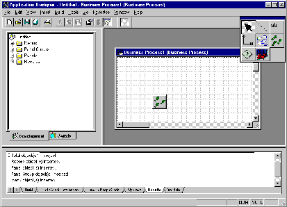

Click on the button with three footprints. Move the pointer over the Business Process window (pointer will change to a box) and press the mouse button. The Activity Choices dialog will be displayed. Select Create New Activity (Figure 2-27). Select OK. This will place an icon of the three footprints in the Business Process window (Figure 2-28).
Figure 2-27 Create a new activity within the business process.
Figure 2-28 The business process with the newly created activity.

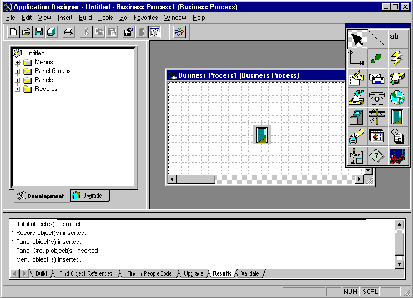

Double click on the BEA_CPSActivity icon in the Business Process window (Figure 2-30). The Business Process window will be blank and the small floating window will now contain several more, different icons (Figure 2-31). Click on the icon that appears to be a door and move the pointer into the Business Process window (the pointer will change to a small box) and click in the Business Process window. This will place the door icon in the window (Figure 2-32).
Figure 2-31 Add a Message Agent Message Definition.
Figure 2-32 The Message Agent Message Definition is added, but not yet defined.

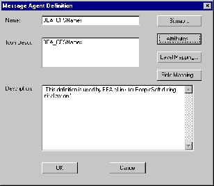

Right click on the door icon in the Business Process window to bring up the Message Agent Definition dialog. Specify BEA_CPSNames in the Name field and press <Tab> (the Icon Description field will be filled in automatically after focus changes from the Name field). For the Description field type: "This definition is used by BEA eLink for PeopleSoft during initialization." Be sure to use the specified capitalization.
Figure 2-33 Name the new Message Agent Message Definition BEA_CPSNames.
Select the Attributes button to bring up the Message Attributes dialog. Specify the following for each of the fields (either by typing in the values or selecting them from the drop-down lists) (Figure 2-34):
If the optional steps were performed as described in "Create a Panel to Access the BEA_CPS Message Definition (Optional)," specify the following values:
Figure 2-34 Attributes for BEA_CPSNames when not for use within PeopleTools.
Select OK to return to the Message Agent Definition dialog.

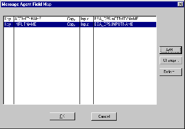

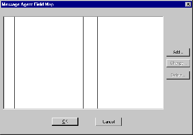

Select the Field Mapping button to bring up the Message Agent Field Map dialog (Figure 2-36). Select the Add button to bring up the Map Field dialog.

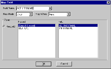

In the Value section highlight (Search Record) in the Record box and then ACTIVITYNAME in the Field box. In the Field Name specify ACTIVITYNAME (Figure 2-37). Select OK to return to the Message Agent Field Map dialog. Select the Add button again to bring back the Map Field dialog.

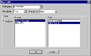

In the Value section highlight (Search Record) in the Record box and then INPUTNAME in the Field box. In the Field Name specify INPUTNAME (Figure 2-38). Select OK to return to the Message Agent Field Map dialog.
Select OK from the Message Agent Field Map dialog (Figure 2-39) to return to the Message Agent Definition dialog. Select OK in the Message Agent Definition dialog to return to the Business Process window.

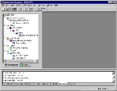

Save the Project by selecting File -> Save Project from the menu. Enter BEA_CPS as the name to save as (Figure 2-41).
Figure 2-42 shows the BEA_CPS project with all the components visible.

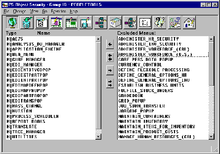

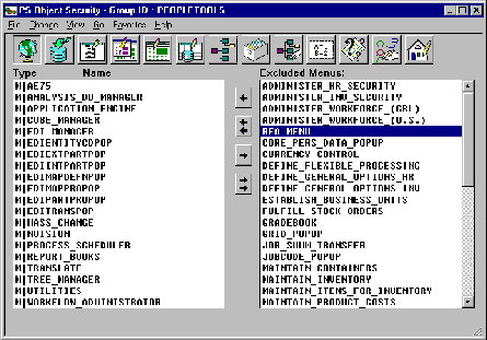

To make the eLink for PeopleSoft menu visible within the PeopleSoft GUI, permissions must be granted to authorized users. Launch the PeopleTools Object Security application.
Open the PeopleTools group by selecting File -> Open -> Group, highlighting PeopleTools, and pressing OK.
From the menu select View -> Menus.
In the Excluded Menus list, on the right side of the window, the BEA_MENU will be listed. Highlight BEA_MENU by clicking on it.
Add it to the usable list by clicking on the single left arrow in the middle of the window.
Save the changes by selecting File -> Save from the menu.
Exit PeopleSoft Object Security by selecting File -> Exit.

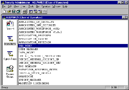

To launch the Security Administrator, select File -> Open. Press the arrow to the right of the Operator/Class Name input field. ALLPANLS will be inserted into the Operator/Class Name field.
Select OK and the ALLPANLS Class displays.

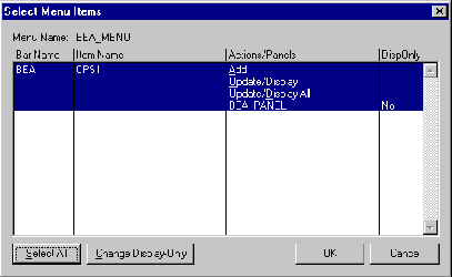

Click on the Menu icon on the left side of the window. Insert the BEA_MENU by selecting Insert -> Menu Name from the menu. This brings up the Insert Menu Name dialog.
Highlight BEA_MENU from the list and select OK to bring up the Select Menu Items dialog.
Press the Select All button and then press the OK button to return to the Security Administrator main window, which now should include BEA_MENU in the menu list.
Save the changes by selecting File -> Save from the menu and then exit the Security Administrator selecting File -> Exit.The BEA Menu will now be available from within the PeopleTools GUI. In order for the menu item to appear, any running PeopleTools Applications must be restarted (e.g. If Security Administrator was launched from within the Application Designer, the Application Designer must be exited and re-started). The BEA Menu will appear under the Go menu item.

Figure 2-36 Add field mapping to the BEA_CPSNames Message Definition.
Figure 2-37 Field mapping without ACTIVITYNAME Message Definition.
Figure 2-38 Field mapping without INPUTNAME Message Definition.
Figure 2-39 Message Definition BEA_CPSNames with required field mappings.

Figure 2-42 All items defined in the eLink for PeopleSoft project.
