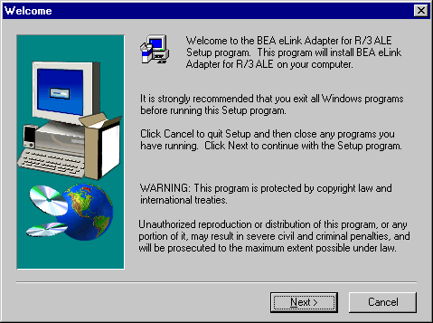

Figure 4-1 Welcome to BEA eLink Adapter for R3 Setup Program

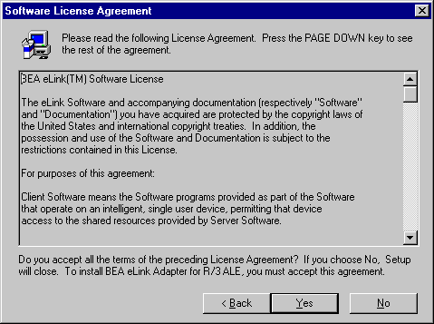

Figure 4-2 License Agreement

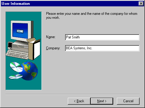

Figure 4-3 Provide User Information

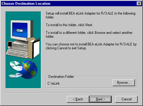

Figure 4-4 Choose Directory Location for Product Installation
If you want to install the BEA eLink product in a folder other than the default, click the Browse button to get the file browser. Use the file browser to locate the directory in which you want to install the BEA eLink Adapter for R/3 ALE and click OK to specify this new path name as the Destination Folder.
Note: It is recommended that you install BEA eLink Adapter for R/3 ALE under a directory named eLink. The host machine where you install and the prefix path to the eLink directory is up to you. For this example, we install on C:\eLink\. Installing on C:\eLink\ actually installs the configuration files to the C:\eLink\adapters\sapr3_ale\config directory and the executable files and dynamic link library to the C:\eLink\adapters\sapr3_ale\bin directory.

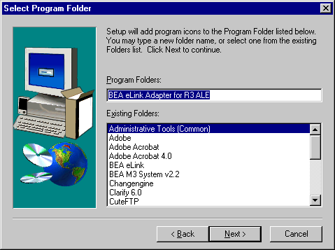

Figure 4-6 Select a Program Folder

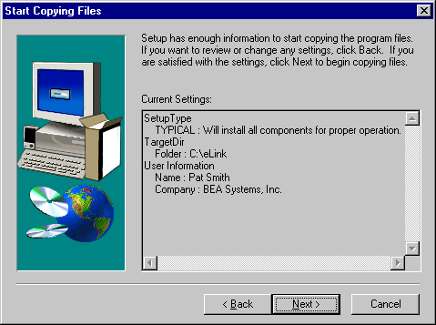

Figure 4-7 Current Settings

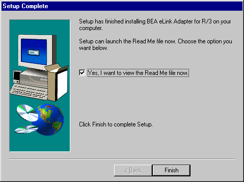

Figure 4-8 Setup Complete
