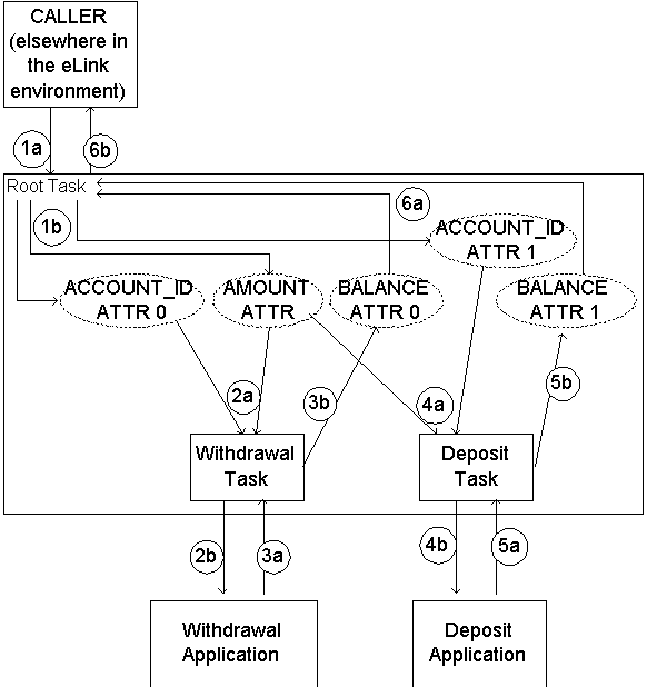

Figure 5-3 shows the data flow through a process.
Figure 5-3 Data Flow Through the Transfer Process
Data Flow By the Numbers
Refer to Figure 5-3 above as the numbered items are explained.
In Step 1a, the caller calls the Transfer process and supplies three input values – the two account numbers (for the withdrawal and deposit accounts, respectively) and the amount to transfer. The input FML Fields from the caller are ACCOUNT_ID[0], ACCOUNT_ID[1], and AMOUNT[0]. However, before these values can be used, they must be assigned to job-level attributes.
As Step 1b indicates, these inputs are assigned to job-level attributes according to the expressions stored in the Root Task parameter attributes. All movement of data between FML Fields and attributes within a process is controlled by parameter assignment expressions. For inputs and outputs to the entire process (at the start and end of the flow), these expressions are stored in the Root Task parameter attributes. The parameter attributes are automatically added to the Root Task by the eLink Process Design Assistant during Template Generation. For this example, we will use the same names for the FML Fields and the corresponding job-level attributes. Since they are job-level attributes they will be qualified by the prefix $JOB.
Hence, the correct parameter assignment expressions for the Root Task are:
$JOB.ACCOUNT_ID[0]=ACCOUNT_ID[0]
$JOB.ACCOUNT_ID[1]=ACCOUNT_ID[1]
$JOB.AMOUNT[0]=AMOUNT[0]
This indicates that:

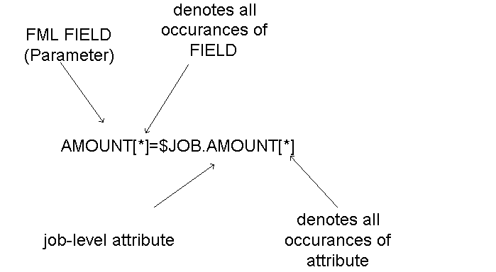

Using a wildcard to refer to all instances of a given attribute or field can further shorten this expression. This is the syntax used by the eLink Process Design Assistant when generating parameter attributes:
$JOB.ACCOUNT_ID[*]=ACCOUNT_ID[*]
$JOB.AMOUNT[*]=AMOUNT[*]
While we will continue to indicate specific instances of the attributes and FML Field occurrences throughout this example, you will typically work with wildcards.
As the process flow runs, the Withdrawal Task becomes ready to execute. In Step 2, the FML Fields for the Withdrawal operation, ACCOUNT_ID[0] and AMOUNT[0] are assigned values from $JOB.ACCOUNT_ID[0] and $JOB.AMOUNT[0] respectively:
ACCOUNT_ID[0]=$JOB.ACCOUNT_ID[0];
AMOUNT[0]=$JOB.AMOUNT[0]
We were looking at the FML Fields ACCOUNT_ID[0] and AMOUNT[0] arriving into the process in Step 1. The values stored in the $JOB.ACCOUNT_ID[0] and $JOB.AMOUNT[0] process attributes during Step 1 will be sent (as FML Fields) to the application in Step 2. This explains why the Root and Withdrawal assignments seem like they are reversed in order.
In Step 3, the result of the funds withdrawal is the ending balance for Account 1, so the parameter assignment for the withdrawal result is:
$JOB.BALANCE[0]=BALANCE[0]
As our process flow continues (not illustrated is the dependency that prevents the Deposit Task from starting before the Withdrawal Task has completed), we arrive at Step 4.
In Step 4, the FML Fields to be sent to the Deposit operation, AMOUNT[0] and ACCOUNT_ID[0] are assigned values from $JOB.AMOUNT[0] and $JOB.ACCOUNT_ID[1] respectively. Note that the second instance of the Account Number (the Deposit Account's Number) is being used. However, since the Deposit operation only expects a single Account Number occurrence zero of the FML Field must be sent. This implies the following parameter assignments:
ACCOUNT_ID[0]=$JOB.ACCOUNT_ID[1]
The result of the funds deposit is the ending balance for Account 2, so the parameter assignment for the deposit result is:
$JOB.BALANCE[1]=BALANCE[0]
Again we can see that the second instance of the Balance process attribute is being updated.
At this point, we have the resulting Balance for the Withdrawal Account in the first instance of the job-level Balance attribute. The second instance of the Balance attribute contains the final Balance for the Deposit Account. Our caller is expecting these results to be returned in two occurrences of the FML Field BALANCE. Therefore, the parameter assignments on the output side of the process (Step 6) are:
BALANCE[0]=$JOB.BALANCE[0];
BALANCE[1]=$JOB.BALANCE[1]

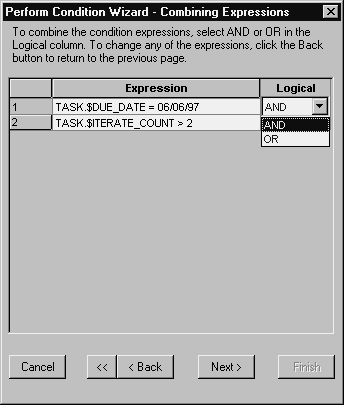

You can combine attribute-operator-value statements with logical operators to form compound statements. Enclosing statements in parentheses is optional; you need parentheses only to change the standard left-to-right order of evaluation (see next section).
For example, to determine if a candidate is eligible for a loan, you might use this PerformCondition:
$JOB.LOAN_AMOUNT > 500 AND $JOB.REFERENCES >= 3 OR $JOB.VP_APPROVAL = 'TRUE'

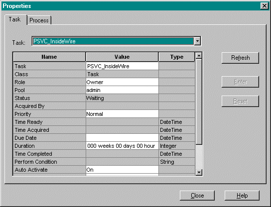

Adding PerformConditions to tasks
Before adding PerformConditions to a task, you must add some key attributes to it. You use the Design Pad to add Perform and IterateConditions to tasks. The Perform Condition and Iterate Condition Wizards consist of pages that assist you as you create a Perform or IterateCondition.
Instructions for Specifying a PerformCondition
To specify a PerformCondition:
  1. Select the task you want to add a PerformCondition to.
  2. In the Task tab of the Property Sheet, select the Perform Condition attribute. The button next to the attribute is enabled.
  3. Click the button. The first page of the Perform Condition Wizard appears, shown in Figure 5-4.

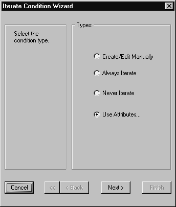

  4. Select one of the following PerformCondition types and click the appropriate radio button:
If you want to make changes on an earlier page while you are working in the Perform Condition Wizard, you can return to that page by clicking the Back button.

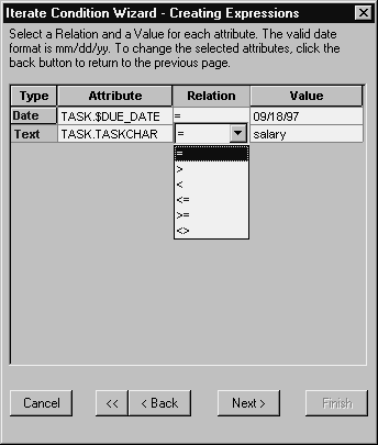

  1. Click the Use Attributes radio button in the first page of the Perform Condition Wizard, then click Next. The Selecting Attributes page appears, shown in Figure 5-5.
    Figure 5-5 The Selecting Attributes page
  2. In the Available Job Attributes or Available Task Attributes listboxes, select the attribute that you want to include in the PerformCondition you are creating. Click the right arrow button to move it to the Selected Attributes box.

  6. Click Next. The Combining Expressions page appears, shown in Figure 5-7. Use this page to combine the expressions that you have just created.
    Figure 5-7 The Combining Expressions page
  7. Combine the individual expressions using AND/OR operators to construct the type of PerformCondition that you want.
    You can change the attribute row order by dragging the button at the left edge of the row up or down the column.

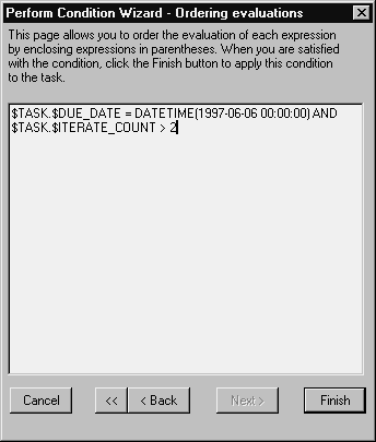

  8. Click Next. The Ordering Evaluations page appears, shown in Figure 5-8, with the PerformCondition that you have created. You can enclose expressions in parentheses on this page to change the order of the evaluations in the new PerformCondition.
    Figure 5-8 The Ordering Evaluations page
  9. Click Finish. The Perform Condition Wizard closes and the PerformCondition appears in the Property Sheet next to the attribute name.

  2. Click Next. The Ordering Evaluations page appears, shown in Figure 5-9.
    Figure 5-9 The Ordering Evaluations page
  3. In the open area, type in the expression you want to use to evaluate the PerformCondition.
  4. When you have finished entering expressions, click Finish. The Perform Condition Wizard closes and the PerformCondition appears in the Property Sheet next to the attribute name.

  3. Click the button. The first page of the Iterate Condition Wizard appears, shown in Figure 5-10.
    Figure 5-10 First page of the Iterate Condition Wizard
  4. Select one of the following IterateCondition types and click the appropriate radio button:
Instructions for Creating an IterateCondition Based on Task Attributes
To create an IterateCondition based on task attributes:
  1. Click the Use Attributes radio button in the first page of the Iterate Condition Wizard, then click Next. The Selecting Attributes page appears, shown in Figure 5-11.

  3. Click Next. The Creating Expressions page displays, shown in Figure 5-12. Use this page to create an IterateCondition expression, by selecting a Relation and a Value for each attribute.
    Figure 5-12 The Creating Expressions page
  4. For each attribute, select an operator from the Relation field.
  5. Enter a value in the Value field. The Type field tells you what type of value is required (text, number, or date).

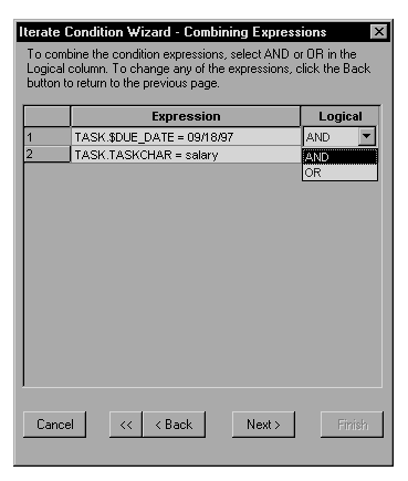

  6. Click Next. The Combining Expressions page appears, shown in Figure 5-13. Use this page to combine the expressions that you have just created.
    Figure 5-13 The Combining Expressions page
  7. Combine the individual expressions using AND/OR operators to construct the type of IterateCondition that you want.

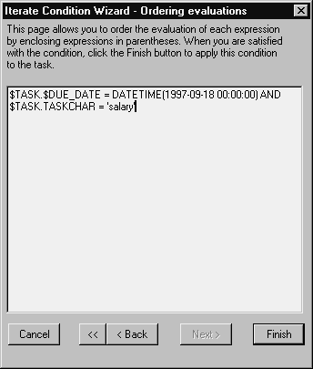

  8. Click Next. The Ordering Evaluations page appears, shown in Figure 5-14, with the IterateCondition that you have created. You can enclose expressions in parentheses on this page to change the order of the evaluations in the new IterateCondition.
    Figure 5-14 The Ordering Evaluations page
  9. Click Finish. The Iterate Condition Wizard closes and the IterateCondition appears in the Property Sheet next to the attribute name.

    Figure 5-15 The Ordering Evaluations page
  3. In the open area, type in the expression you want to use to evaluate the IterateCondition.
  4. When you have finished entering expressions, click Finish. The Iterate Condition Wizard closes and the IterateCondition appears in the Property Sheet next to the attribute name.

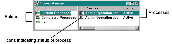

Figure 5-16 The Process Manager window
The icons to the left of each process name represent the status of the process. When you move your cursor over the icon, the status bar shows you the status message.
The Process Manager includes two standard folders:
You can also create personal folders to group processes. In the example above, the user has created a personal folder and copied process definitions that she regularly starts.

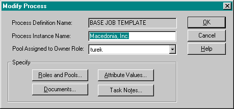

Modifying a process instance in progress
You can modify assignments for tasks that have not yet been completed. These assignments include:
When you modify a process, that process automatically suspends. When you are done modifying the process, it automatically resumes.
Instructions for Modifying Parts of a Process
To modify parts of a process:
  1. Select the process you want to modify in your Current Processes folder.
  2. Choose Process > Modify. The Modify Process dialog box appears, shown in Figure 5-20.
    Figure 5-20 The Modify Process dialog box
  3. When you are done modifying the process, click Close.

Instructions for Viewing the Properties of a Task
To view the properties of a task:
Select a task in the right pane of the Process Manager window. Choose View > Properties. The Task Property Sheet appears in read-only mode, shown in Figure 5-24, allowing you to view but not change the task properties. Click Close to close the Property Sheet.
Figure 5-24 The Task Property Sheet

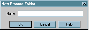

Instructions for Creating a New Folder
To create a new folder:
  1. Choose Folder > New. The New Process Folder dialog box appears, shown in Figure 5-25.
    Figure 5-25 The New Process Folder dialog box
  2. Enter the name for a folder and click OK. The new folder is created and displayed in the hierarchy pane of the Process Manager window. The new folder is empty and you can find and add processes to the folder.
  3. Click Cancel to cancel creating the folder.

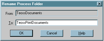

Instructions for Renaming a Folder
To rename a folder:
Select the folder you want to rename. Choose Folder > Rename. The Rename Folder dialog box appears, shown in Figure 5-27. Enter a new name for your folder in the To box and click OK.
