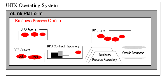

Figure 1-1 provides a graphical overview of the Business Process Option components.
Figure 1-1 Business Process Option Architectural Overview
The sections below provide descriptions of primary Business Process Engine and Business Process Option components.
Business Process Engine Components
The Business Process Engine does the following:
The Business Process Engine consists of four eLink Platform servers, a number of applications, a database, and a repository of documents. Important runtime configration information is stored in the <$IC_HOME>/config directory. Additional platform configuration information is stored in the platform environment file (by default eLink_BPO.env). The Business Process Engine eLink Platform servers are located in the directory <$IC_HOME>/tuxapp.

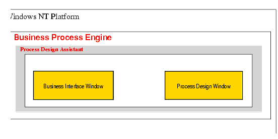

Process Design Assistant
The main Business Process Engine Client component is the Process Design Assistant (PDA). This component, in turn, comprises the following subcomponents:
Figure 1-2 illustrates the structure of the Process Design Assistant.
Figure 1-2 Business Process Engine Client Components
Process flows may have external documents "attached" to them. The Document Repository is where information regarding these attachments is maintained. The data is stored in a directory or set of directories and maintained by the Business Process Engine by way of the IcRepDaemon Server and other Engine applications.
