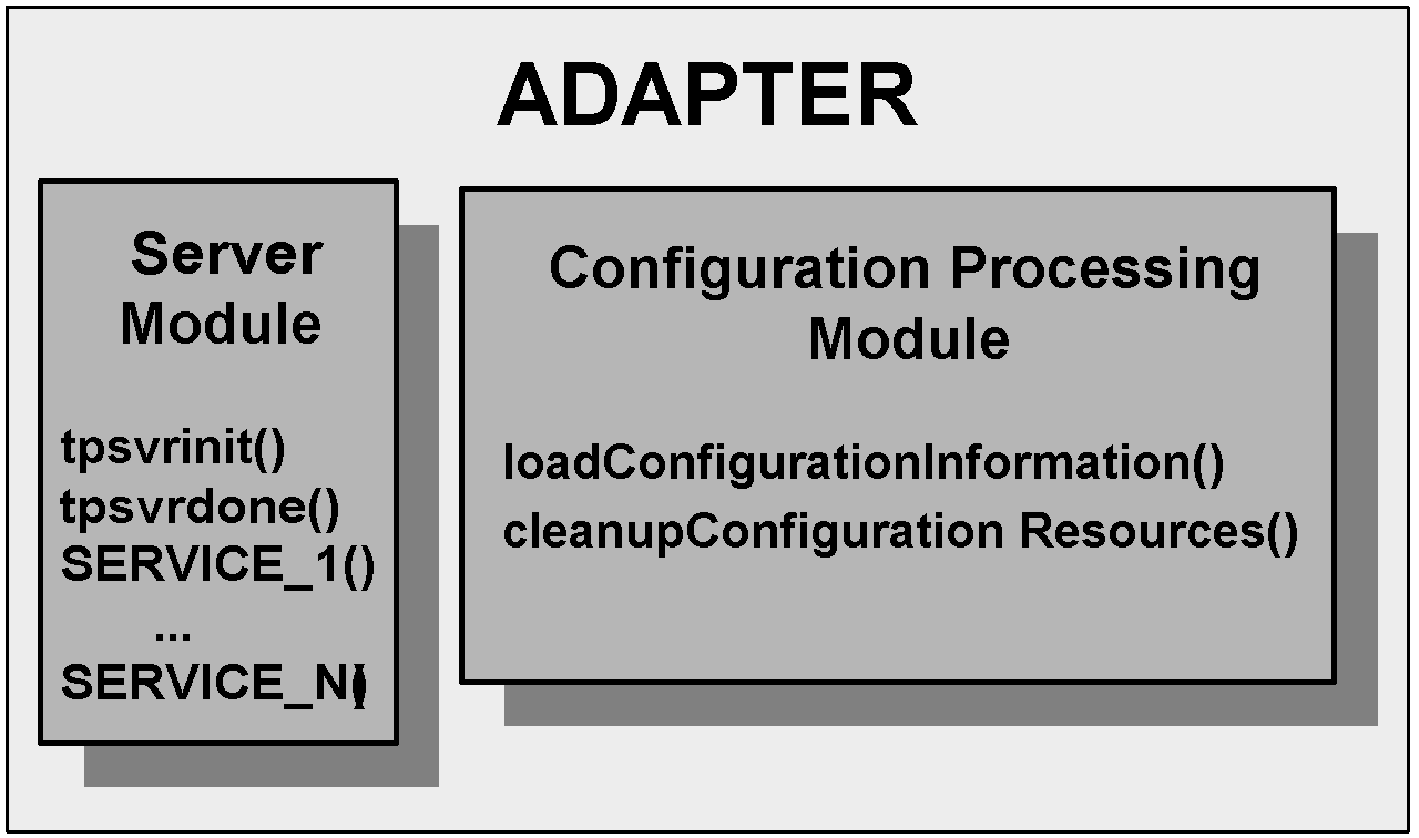

The standard design for an eLink adapter consists of at least two distinct program modules, the Server Module and the Configuration Processing Module.
Figure 3-1 Standard Adapter Design
The Server Module contains the code for the functions that perform the services advertised by the server. The Server Module also contains the code for the tpsvrinit function, which is called when the server is booted, and the tpsvrdone function, which is called at server shutdown time.
The tpsvrinit function performs the following tasks:
Warning! eLA_chkeLinkLic must be called to verify the eLink platform release. Failure to do so may result in incorrect runtime behavior in the adapter.
Functions in the ADK library or the ATMI API facilitate most of these tasks.
The following table provides descriptions of the calls made by the tpsvrinit function.

The Configuration Processing Module
Parsing and processing of the configuration file is done by the loadConfigurationInformation and cleanupConfigurationResources functions in the Configuration Processing Module. These functions make use of the ADK API functions for parsing, processing, and storing the configuration data.
Adapter Design Pseudo Code
Following is an example of a pseudo code outline that gives an overview of the general design of an adapter. The pseudo code outline follows these conventions:
In the pseudo code example, the server module has functions that support N services named SERVICE_1 through SERVICE_N; however, SERVICE_1 is the only service with any example code given.

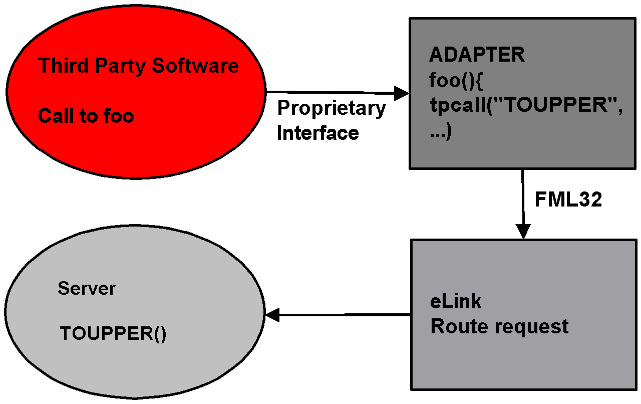

Application to eLink Adapters
Application to eLink adapters translate requests initiated by the third-party software (for example, SAP, Broadvision, or MQseries) into standard eLink ATMI calls, such as a tpcall. The application to eLink adapter is an eLink server that will probably run as a "daemon" process. You can run the server as a daemon process by making a tpacall with the TPNOREPLY flag set to the daemon service from the server's tpsvrinit function. The daemon process starts when the server is booted. The code for the daemon service contains an infinite loop. Inside the loop, the server checks for input from the third-party software.
The method of communication between the third-party software and the adapter depends on the third-party interface. For example, for an MQSeries adapter, requests are written to a queue by MQSeries and the adapter monitors that queue. The eLink Platform routes the request. The Bulletin Board Liaison (BBL) consults the Bulletin Board to find the name of the server that has advertised the requested service. The BBL then resolves the service name into a fully qualified address and sends the request to the server. The server or other adapter that advertises the desired service must be provided by the customer and is not part of the application to eLink adapter. However, in order to test an adapter, the adapter must be able to call an eLink service, so an eLink server that processes such a request should be part of a test for the adapter.
Note: All communication between the originating adapter and the adapter that services the request should be in FML32.
Following is an example of the server code that is specific to application to eLink adapters.
Listing 3-4 Server Module Code
tpsvrinit(argc,argv){
tpacall("DAEMON",...,TPNOREPLY);
return(0);
DAEMON (...){
for(;;)
//Check for requests from third-party application
Following is an illustration of the typical request path for an application to eLink adapter.
Figure 3-2 Typical Request Path for an Application to eLink Adapter

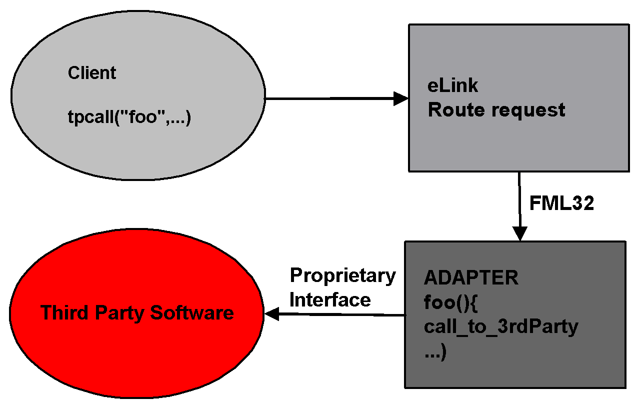

eLink to Application Adapters
eLink to application adapters translate requests made by requesting applications into calls to the API of third-party software. The eLink to application adapter is a server. A tpcall (or tpacall) initiates the request. The service name is defined by a parameter in the tpcall. The eLink Platform makes an association between the service name and a server, or adapter, that advertises that service. The service, a function defined in the adapter, makes a call to the third-party API. The interface between the adapter and the third-party software is defined by the third-party software.
The sample eLink to application adapter included with the ADK is a complete working example of an eLink to application adapter. Client code is provided to initiate the request. In real environments this originating call might be from another adapter or the Business Process Option. This code is not part of the adapter, however such a client should be written to test the adapter.
Following is an illustration of the typical request path for an eLink to application adapter.
Figure 3-3 Typical Request Path for an eLink to Application Adapter
