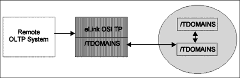

Using eLink OSI TP as a Pass-Through to Other Tuxedo Systems
For this example, the eLink OSI TP gateway acts as a pass-through to allow access to services on other Tuxedo systems. The eLink OSI TP gateway receives service requests from a remote OLTP system and then forwards them through the /TDOMAINS gateway to a remote Tuxedo system. The systems are as follows:
Figure 4-1 Example of eLink OSI TP Acting as a Pass-Through to Other Tuxedo Systems

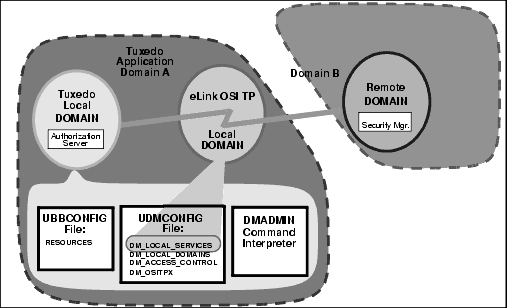

Setting up Security
BEA eLink OSI TP supports the following two types of security:
The BEA Tuxedo UBBCONFIG and eLink OSI TP DMCONFIG files include five sections in which you specify security parameters for whichever type of security you want to implement:
The following figure shows the relationships between security elements for eLink OSI TP.
Figure 4-2 eLink OSI TP Security Elements
Enabling Link Layer Security To enable security, both the local and remote domains must support security. For Link Layer Security (LLS), the administrator must define the SECURITY in the *LOCAL_DOMAINS section as DM_PW and the OPTIONS parameter in the DM_OSITPX section must be set to SECURITY_SUPPORTED. The Local and Remote domain passwords should be set by the administrator through the dmadmin command passwd. Whenever Link Layer Security is defined for the local domain and the remote domain, the passwd entered through dmadmin is hashed with a private key. The hashed value and private key are sent to the remote domain where it is compared with the hashed passwd on the remote system. This is a challenge response mechanism used to secure connections with a remote domain. Three sections in the DMCONFIG file contain parameters affecting how eLink OSI TP controls access to the local Tuxedo domain:
The SECURITY parameter settings in this section work in conjunction with the SECURITY parameter in the RESOURCES section of the Tuxedo domain's UBBCONFIG file to establish how eLink OSI TP controls access to the Tuxedo local domain. If this parameter is set to NONE or APP_PW, the eLink OSI TP domain takes no action with regard to security. If this parameter is set to DM_PW, the eLink OSI TP domain enforces security according to the security settings in the DM_PASSWORDS section of the BDMCONFIG file.
Caution: Do not delete the Tuxedo BDMCONFIG file. The DM_PW information will be lost if the file is deleted. When new passwords are entered, the GWOSITP service must be shut down and restarted for the passwords to take effect.
Refer to Enabling Tuxedo Authentication for more information about Tuxedo security.
The following sample is a DMCONFIG file that defines the necessary parameters for establishing Link Layer Security.
Listing 4-8 Sample DMCONFIG File for Establishing Link Layer Security

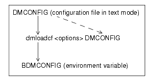

Processing a Configuration File with the dmloadcf Utility
The dmloadcf utility compiles the DMCONFIG file and creates a binary configuration file, BDMCONFIG, which is used by the DMADM server to control the run-time environment.
Figure 4-3 shows how the dmloadcf utility processes the configuration file. A description of the process follows the figure.
Figure 4-3 dmloadcf Process
Invoking the dmloadcf Utility The dmloadcf utility is invoked from a command line with the following syntax: where the following options are valid:
dmloadcf [-c] [-n] [-y] [-b blocks] [-k] DMCONFIG_file
How the dmloadcf Utility Works
The dmloadcf utility prints an error message if any required section of the DMCONFIG file is missing. If a syntax error is found while parsing the input file, dmloadcf exits without performing any updates to the BDMCONFIG file.
A Tuxedo DMTYPE file is required to define the valid domain types. If this file does not exist, dmloadcf exits without performing any updates to the BDMCONFIG file.
The effective user ID of the person running dmloadcf must match the UID in the RESOURCES section of the TUXCONFIG file.
After syntax checking, dmloadcf verifies that the file pointed to by BDMCONFIG exists, is a valid Tuxedo System file system, and contains BDMCONFIG tables. If these conditions are not true and the -y option was not entered on the command line, the user is prompted to create and initialize the file with
Initialize BDMCONFIG file: path {y, q}?
where path is the complete file name of the BDMCONFIG file and "Y" indicates that the configuration file should be created.
If the BDMCONFIG file is determined to already have been initialized, dmloadcf ensures that the local domain described by that BDMCONFIG file is not running. If a local domain is running, dmloadcf prints an error message and exits. Otherwise, dmloadcf confirms that the file should be overwritten by prompting the user with:
"Really overwrite BDMCONFIG file {y, q}?"
Prompting is suppressed if the standard input or output are not terminals. Any response other than "y" or "Y" causes dmloadcf to exit without creating the configuration file. If the BDMCONFIG file is not properly initialized and the user has responded with "Y", dmloadcf creates the Tuxedo file system and then creates the BDMCONFIG tables.
If the SECURITY parameter is specified in the RESOURCES section of the TUXCONFIG file, then dmloadcf flushes the standard input, turns off terminal echo, and prompts the user for an application password.
Assuming no errors, and if all checks have passed, dmloadcf loads the DMCONFIG file into the BDMCONFIG file and overwrites all existing information found in the BDMCONFIG tables.
The following example shows how a binary configuration file is loaded from the bank.DMCONFIG ASCII file. The BDMCONFIG device is created (or reinitialized) with 2000 blocks:
dmloadcf -b 2000 -y bank.dmconfig
