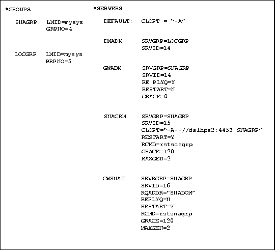

Enter the UBBCONFIG Parameters
To specify the SNACRM as a BEA TUXEDO server, provide the equivalent UBBCONFIG parameters shown in the example in Figure 5-1.
Figure 5-1 Example UBBCONFIG File Entries Specifying SNACRM as BEA TUXEDO Server
Write the Script
The executable script rstsnagrp should reside in the APPDIR and contain the following lines:
# Filename = rstsnagrp
tmshutdown -g SNAGRP
tmboot -g SNAGRP

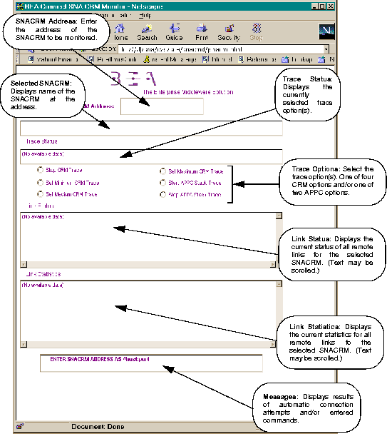

Set up your applet version to monitor either a local or a remote SNACRM. To do this, you make selections on the Java(TM) Plug-in Properties control panel. This control panel is automatically downloaded with the plug-in and is initiated from the Windows Start Programs pop-up menu. Refer to on-line documentation about the control panel at the following internet location:
http://java.sun.com/products/plugin/1.1.1/docs
Once the Monitor screen displays (Figure 5-2), you enter in the field at the top of the screen the address of the SNACRM you want to monitor.
To monitor a local SNACRM, select Applet Host from the Network access drop-down menu. Type the following in the Enter SNACRM Address panel:
//localhost:port
where:
localhost
Explicitly specifies the local host.
port
Specifies the port number of the SNACRM on the local host.
To monitor a remote SNACRM, select Unrestricted from the Network access drop down menu. Type the following in the Enter SNACRM Address panel:
//remotehostname:address
where:
remotehostname
Specifies the remote host.
address
Specifies the network address of the SNACRM on the remote host.
The GUI contains two screen areas that require user entry and four screen areas that display information about the SNACRM being monitored. Status messages are displayed at the bottom of the screen. The GUI screen functions are listed in Table 5-1 and shown in Figure 5-2.
Table 5-1 SNACRM Monitor Screen Functions
Display Section Function
SNACRM Address
This is where you enter the address of the SNACRM to be monitored.
Selected SNACRM
Displays the name of the SNACRM at the address entered in the address field.
Trace Status
Displays the currently selected trace options.
Trace Options
Link Status
Displays the current status of all remote links for the selected SNACRM. (Text may be scrolled.)
Link Statistics
Displays the current statistics for all remote links for the selected SNACRM. (Text may be scrolled.)
Message Line
Displays messages showing the either the results of automatic connection attempts or commands issued to change the trace options.
Figure 5-2 The SNACRM Monitor Running as an Applet on a Network Browser

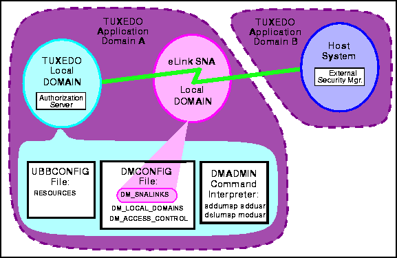

Security Overview
In order for any security checking to occur, the BEA TUXEDO Local Domain and the Host System must have security mechanisms in place. For the Local Domain, this is the Authorization Server. For the Host System, this is the External Security Manager. Figure 5-3 shows these elements.
There are four sections in two BEA TUXEDO configuration files in which you specify parameters bearing on Local Domain security. The two configuration files are DMCONFIG and UBBCONFIG.
Userid and password mapping between the Local Domain and the Host System also bears on security. There are five DMADMIN subcommands which you use to enter userids and passwords, set up mappings, remove mappings, remove userids and passwords, and modify passwords.
Caution: Mixed environment security is more complex than depicted in Figure 5-3. A domain without an operational security mechanism in place accepts all transaction requests by treating userids as "trusted users." Refer to BEA TUXEDO documentation for more detailed information about domain security.
Figure 5-3 BEA eLink for Mainframe SNA Security Elements
Where You Specify Security Parameters
The configuration sections where security is specified are:

The combined settings of the SECURITY parameters in the UBBCONFIG and the DMCONFIG files have the following effects:
If security is to be enforced by both the local domain and the host system for each request inbound from the host system to the local domain, the following settings must be made:
(Refer to Table 5-2 for a summary of the file settings required to achieve different security combinations for inbound requests from the host system.)
If security is to be enforced by both the local domain and the host system for each request outbound from the local domain, the following settings must be made:
(Refer to Table 5-3 for a summary of the file settings required to achieve different security combinations for outbound requests from the local domain.)
For a request sent to the host system, the local principal userid is located in the domain security table and the associated remote userid, or userid and password, are put into the conversation start-up request before being sent over the LU6.2 conversation. (This occurs if SECURITY is set to IDENTIFY or VERIFY in the DM_SNALINKS section of the DMCONFIG file.)
For requests sent from the host system, the local domain extracts the remote userid, or userid and password, from the conversation start-up request and checks the domain security table. That table contains pairs of local principal userids and remote userids, maintained on a service-by-service basis. The remote userid is mapped to the local principal userid. The local principal userid and password are used for further Access Control List (ACL) checking, as specified in the UBBCONFIG file.
When a request is received from the host system, the local domain checks the DMCONFIG file ACL for the local service to see if requests from the remote domain are permitted. If the DMCONFIG file does not contain an ACL for the local service, the service is accessible to all requests.
Therefore, if the ATTACHSEC level for the connection definition in the host system is Identify or Verify, the DMCONFIG SECURITY parameter must be set to DM_USER_PW so that a userid and a password are sent on the conversation start-up requests.

After setting up and/or checking the security settings for the BEA TUXEDO domain and the host system, you must relate the security information in both domains to each other. To do this, use the addusr and addumap subcommands provided with the dmadmin command interpreter.
Once the user security information in both domains is mapped, you can perform administration on the affected security files in each domain. To do this, use the delumap, modusr, and delusr subcommands.

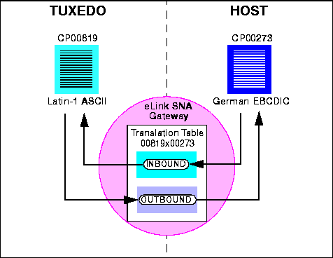

The character set translations performed by eLink SNA are fully localizable, in accordance with the X/Open XPG Portability Guides. ASCII and EBCDIC translations are loaded from message files. Refer to "Programming Language String Transformation" for more information.
The eLink SNA software contains default behaviors which should meet the requirements of most English-language applications. However, you may find it necessary to customize tables. Refer to "Code Page Translation Tables" for more information.

Each translation table consists of two mapping tables, one for outbound conversions (TUXEDO to host) and one for inbound conversions (host to TUXEDO). You do not have to specify the direction of a translation. All you have to determine is the national language in which the host application is written. Figure 5-4 illustrates code page translation.
Figure 5-4 eLink SNA Code Page Translation
The figure demonstrates how a TUXEDO application using the Latin-1 ASCII code page CP-00819 character set operates with a host application using German EBCDIC code page CP-00273. The eLink SNA translation table 00819x00273 provides both the inbound and outbound conversions.
