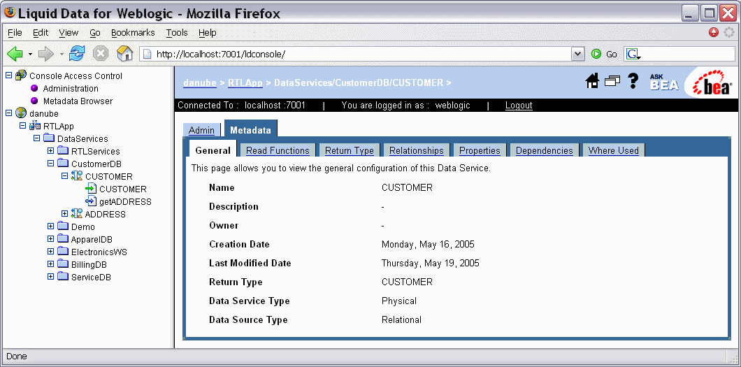

To browse data service metadata:
  1. Select a data service in the Navigation pane.
  2. The Admin screen appears.
  3. Click the Metadata tab.
  4. The console displays the General metadata associated with the data service, as ill.ustrated in Figure 8-1.
    Figure 8-1 Data Service Metadata
  5. Click the corresponding tab to display general information, data service read functions, return type, relationships, properties, dependencies, and where used information.
  6. Table 8-1 describes the metadata information accessible through the tabs.
    Table 8-1 Metadata Information
    Tab
    Description
    General
    Provides general configuration information about the data service, including the following:

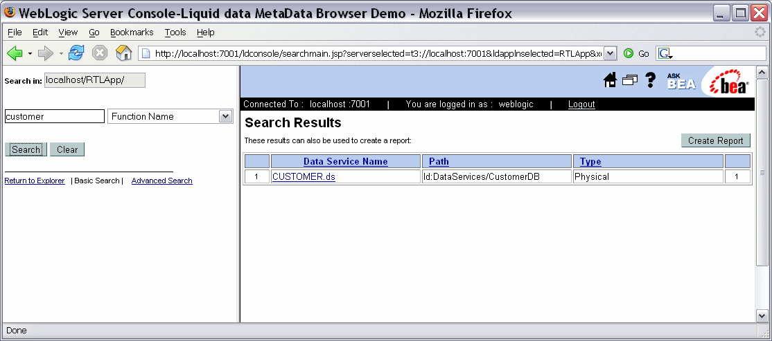

Exploring Metadata Search Results
The Metadata Browser displays basic and advanced search results in the Contents pane. The information displayed is the same for both types of searches. Figure 8-7 illustrates the search results page.
Figure 8-7 Metadata Search Results
Table 8-4 describes the information displayed as search results.
Table 8-4 Search Results Information
Search Result
Description
Name
The name of the data service.
Path
The path identifying the data service.
Type
Either physical or logical. For more information about data service types, see Understanding Data Service Metadata on page 8-5.

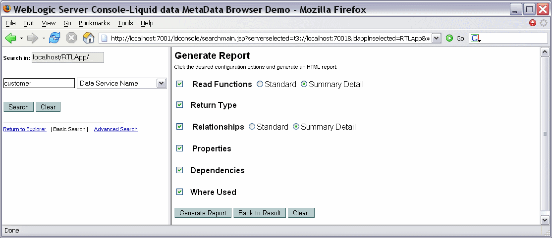

Generating Reports
You can generate an HTML report based on the results of a basic or advanced search. In preparing the report, you specify the information to include such as read functions, return type, relationships, and more.
To generate a report:
  1. Right-click on a Liquid Data application or project node in the Navigation pane, and choose Search in the context-sensitive menu.
  2. The basic search screen appears. The advanced search tool is available as a link below the basic search interface.
  3. Specify the criteria for either a basic or advanced search, and click Search.
  4. The search results appear in the Contents pane.
  5. Click Create Report in the Content pane to generate a report from the search results.
  6. The Generate Report page appears, as illustrated in Figure 8-8, enabling you to specify the information to include in the generated report.
    Figure 8-8 Generating Reports
    Generating Reports
  7. Select the information you want to include in the report, and click Generate Report.
  8. The generated report appears in the Contents pane. Alternative, you can click Clear to reset the Generate Report page, or click Back to Result to return to the search results.
  9. Click Return to Explorer to exit the search facility and return to the main interface.
Table 8-5 describes the options you can select to defined the information included in the generated report.
Table 8-5 Report Information
