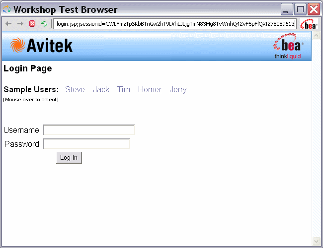

The appearance of a login page in the Workshop Test Browser, as illustrated in Figure 4-2, indicates that Liquid Data is correctly installed and running.
Figure 4-2 Login Page in the Workshop Test Browser
