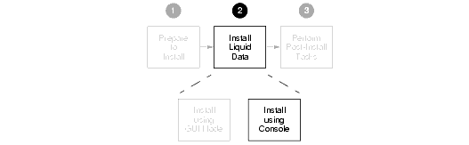

Figure 3-1 illustrates the current step in the overall installation process.
Figure 3-1 Console Mode Installation Step
