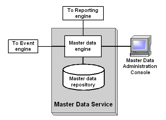

Master data does not grow merely because more business is transacted. It is not typically tied to specific moments in time and provides interpretation for elements of event data.
Master data is business-context information that is associated with event data by the reporting service and by the data exchange service (queries for events can include parameters that filter query results based on master data).
Master data is not present in the captured event data in the WebLogic RFID Enterprise Server 2.0 release; it is created and maintained separately. The relationship between event data and master data is that event data can be used as an index into relevant master data. For example, consider an event that contains following event type and value:

Types and the attributes associated with them are extensible: you can use the WebLogic RFID Enterprise Server Master Data Administration Console to create and modify master data types, entries, and attributes.
