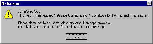

The context-sensitive help system requires that Netscape Communicator version 4.0 or above be present on the local system and in use. If you are using an earlier version of the Netscape browser, you will get an error message when you try to use the Find or Print buttons. (See Figure 2.)
Figure 2 Error Message on the Help System if Communicator is Not the "Active" Netscape Browser
Note that even if you have Communicator 4.0 installed, you can still get this error if you also have earlier versions of the Netscape browser and one of these down-level versions was the last browser used. The remedy for this problem is to close out of the current BEA TUXEDO Builder application, close any earlier versions of the Netscape browser (if you have some open) and open Communicator 4.0. (You can close Communicator as soon as you have opened it.)
When you re-start the Builder application, the Help system should work properly.
