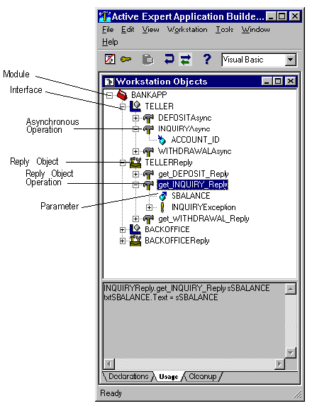

    This shows the workstation objects in asynchronous mode as shown in Figure 3-5.
    Figure 3-5 Workstation Objects in Asynchronous Mode
In the figure, the module BANKAPP is expanded to show the asynchronous operations contained in the TELLER interface. Note that the asynchronous operations are named in the form OperationNameAsync. The sample code shown returns the requested values as output parameters of the selected reply object operation.
