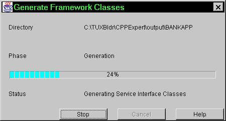

Generate Framework Classes
The Generate Framework Classes window allows you to generate the code and make files needed to compile the application within a specific environment.

Table 7-15 Fields on the Generate Framework Classes window
Field Description
Directory
During generation, this field displays the directory where the files are being created. This directory is specified in the Project Root Directory field of the Generate Settings window. (During installation this is set to:
YourDrive:TUXBldr\CPPExpert\output (Windows NT)
<Builder_Install_dir>/client/CPPExpert/output (UNIX)
Phase
During generation, this field displays which part of the generation process is occurring. There are three phases:
Progress Bar
During generation, this field graphically shows how much of the process is completed.
Status
During generation, displays the action of the current Phase.
Description

Buttons
The following table describes the buttons on the Generate Framework Classes window.
Table 7-16 Buttons on the Generate Framework Classes window
Button Description
Start
Starts the generation phase. During generation, is replaced with the Stop button.
Stop
Stops a currently running generation phase.
