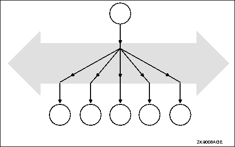

MessageQ SBS works in a fashion similar to radio broadcasting. A MessageQ sender program directs a message to a selected broadcast stream or "channel." Then, the receiver program "tunes in" by sending a registration message to the SBS Server thus registering to receive messages broadcast over that channel. This feature is also called "publish and subscribe" in the messaging industry.
When a broadcast message is distributed, any receiver program registered for the broadcast channel will receive the message. Receiver programs that are not registered will not receive the message. Similar to radio broadcasting, where many radio stations are broadcasting at the same time, MessageQ can distribute different types of messages over different broadcast channels.

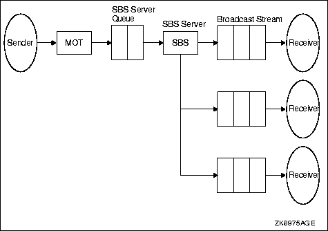

To send a message to multiple recipients simultaneously, the sender program uses the pams_put_msg function and specifies a Multipoint Outbound Target (MOT) as the target address for the message. A MOT, numbered between 4000 and 6000, is the identifier for a broadcast stream. A broadcast stream is the set of target queues registered to receive messages directed to a particular MOT.
Continuing our analogy with radio broadcasting, a MOT is equivalent to a radio station that people tune in to. When a message is sent to a MOT, any receiver program registered for the MOT will receive the message.
Each MessageQ message queuing group can be configured to support message broadcasting by setting the ENABLE_SBS parameter in the Profile section of the group initialization file. The default value for this parameter is YES. Therefore, by default, an SBS Server is started for each message queuing group to support both message broadcasting and MessageQ queue availability notification (AVAIL services). Receiver programs may register a queue address with any SBS Server. Any message directed to a MOT address is automatically redirected to the group's SBS Server.
The SBS Server uses its registration database to distribute the message to all applications that have registered to receive the selected message. Figure 3-1 illustrates the flow of messages in the broadcast stream.
Figure 3-1 MessageQ Broadcast Stream

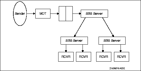

Each SBS Server in the MessageQ network is responsible for ensuring that the submitted message conforms to the rule set of registered users and for distributing the messages locally.
For example, the stock brokerage application we mentioned may need to supply updated stock prices to receiver programs on many systems in a distributed network. This application would be most likely to use a universal broadcast stream to expedite the flow of information throughout the network.

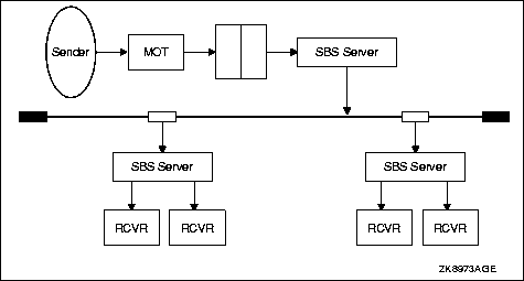

All MessageQ Servers support message broadcasting using datagrams transmitted using the MessageQ transport. Datagrams are then transferred over a MessageQ cross-group link (TCP/IP or DECnet) to another MessageQ Server process and are queued to the receiving SBS Server. Since the broadcasting to each SBS Server is simulated over point-to-point links, one copy of a message must be sent to each SBS Server. Datagram delivery mode can be used for both private and universal broadcast streams. Figure 3-2 illustrates SBS message broadcasting using the MessageQ transport.
Figure 3-2 SBS Broadcasting Via MessageQ Transport

Figure 3-3 SBS Broadcasting Via Ethernet Transport

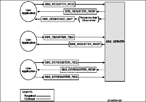

To receive broadcast messages, applications use a standard set of MessageQ messages to register for receipt with the SBS Server in their local group or in a remote message queuing group. Figure 3-4 illustrates the flow of messages sent to the SBS Server.
Figure 3-4 SBS Server Message Flow
The following sections describe:
Registering to Receive Broadcast Messages
To receive broadcast messages, an application registers a queue address with the SBS Server managing a broadcast stream. The queue address for the SBS Server in a message queuing group is queue number 99. Any MessageQ primary, secondary, or multireader queue can be registered to receive broadcast messages.
Receiver programs register for broadcast messages using the pams_put_msg function sending a standard MessageQ registration message. Typically, registration messages are sent to the primary queue of the local SBS Server queue (SBS_SERVER), which is queue 99 in the local group. The registration message contains the MOT of the broadcast stream plus any selection criteria related to messages that the application wishes to receive. An application can also register with a remote server by sending the registration message to the primary queue of the SBS Server in the remote group. (For example, 10.SBS_SERVER).
MessageQ provides the SBS_REGISTER_REQ and SBS_REGISTER_RESP messages. Use SBS_REGISTER_REQ to request to register to receive broadcast messages. Your application receives the SBS_REGISTER_RESP in response to the SBS_REGISTER_REQ request message.
The registration information for each broadcast stream is stored in memory by each SBS Server and is volatile. Users registered with a remote SBS Server will no longer receive broadcast messages after the link to the remote server goes down. To recover from cross-group link failures, the application must monitor the status of the link to the remote SBS Server and be prepared to reregister for broadcast messages after a downed link is restored.
The receiver application can request sequence gap notification using the SBS_REGISTER_REQ message. The SBS Server maintains sequence checking on each broadcast stream. Sequence gaps occur when resource exhaustion and overflow conditions interrupt the reception of a broadcast stream by an SBS Server. For example, sequence gaps occur when a sender program broadcasts at a higher rate than the SBS Server can receive and distribute messages. When this characteristic is enabled, the SBS Server sends a message of type SBS_SEQUENCE_GAP to the target queue whenever a sequence gap is detected.
Sequence checking operates on the MessageQ network and on the Ethernet LAN. On Ethernet, the channel and MOT number are returned in the sequence gap notification message. Broadcast messages are not recoverable; therefore, the occurrence of repeated sequence gap messages signals the need to synchronize application processing in the distributed network.
Broadcast streams hold messages for a short period of time only; therefore, receiver queues must be configured with a sufficient message receive quota to store messages as they arrive. As with any MessageQ system, you must test the send and receive rates of programs to ensure that messages are not sent faster than they can be received.
