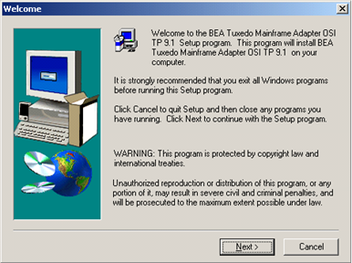

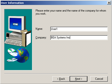

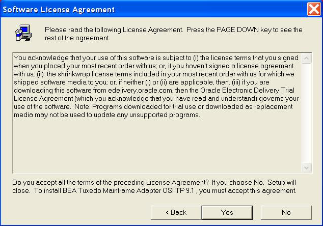

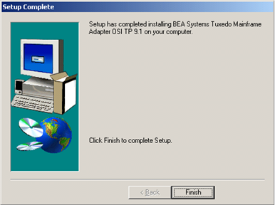

Perform the following steps to install the TMA OSI TP product on a Windows 2003 operating system:
| WARNING: | For Windows 2003 operating systems, the BEA Tuxedo system should be installed first and the TMA OSI TP product should be installed within the same directory. |
windows directory and select the Setup.exe program. | Note: | If the Tuxedo product is NOT already installed on your system, an Error pop-up window displays. Click OK on the pop-up window to terminate the installation process. Install the Tuxedo product on your system and re-instate the installation process. |
| Note: | During the TMA OSI TP installation, the $TUXDIR\udataobj\DMTYPE file is updated to include an OSITPX entry if one is not already there. |
The TMA OSI TP CD-ROM contains the following libraries and executable programs for Windows 2003 operating systems. After installing the TMA OSI TP product, verify that these files and programs are installed on your system.

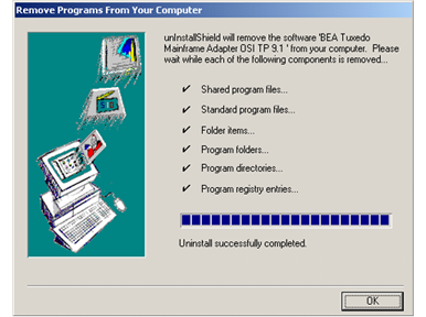

Perform the following steps to uninstall TMA OSI TP on a Windows 2003 system:
| Note: | Make sure that TMA OSI TP is shut down before you uninstall. |
