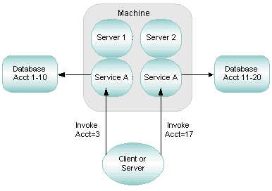

Suppose two clients in a banking application issue requests for the current balance in two accounts: Account 3 and Account 17. If data-dependent routing is being used in the application, then the Oracle Tuxedo system performs the following actions:
The following figure illustrates this process.

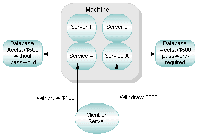

A banking application includes the following rules:
Two clients issue withdrawal requests: one for $100 and one for $800. If data-dependent routing is enabled to support the withdrawal rules, then the Oracle Tuxedo system performs the following actions:
