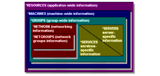

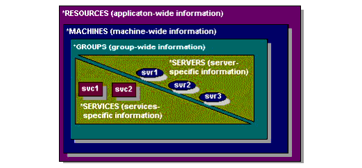

Configuration file requirements are determined by the needs of your application. Following are instructions for several types of configurations:
For a single-machine configuration, you need to create the following sections of the configuration file. Click on each task for instructions on completing that task.
You can also click on any area of the following diagram to learn how to create the section named in that area.

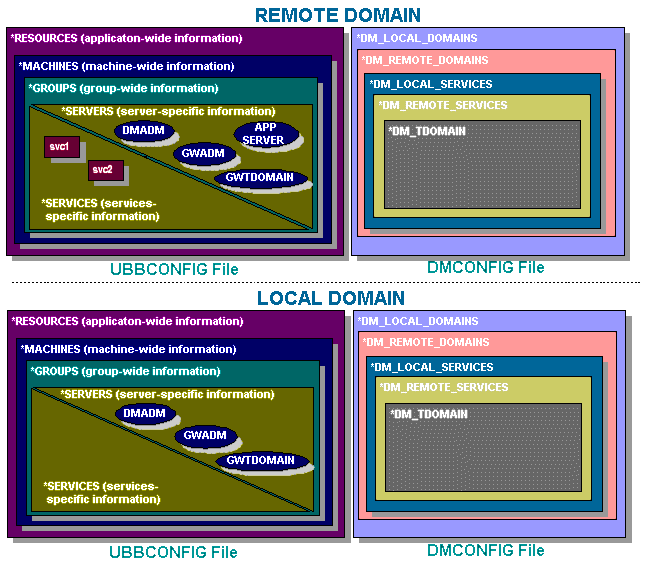

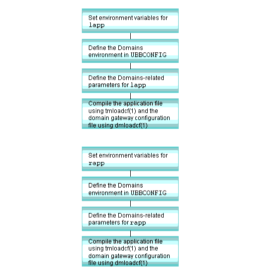

For a multiple-domain configuration, you need to create two configuration files for each participating domain:
For an application that consists of two domains (for example, lapp and rapp for local and remote domains, respectively), the following tasks are required.
The following diagram shows which sections of the UBBCONFIG and DMCONFIG files you need to configure for a two-domain application. One domain represents the local domain; the other, the remote domain.
Click on any area of the following diagram for instructions on creating that section of the configuration file.
