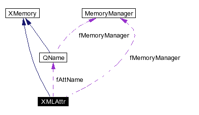

Inheritance diagram for XMLAttr:  [legend]Collaboration diagram for XMLAttr:  [legend]List of all members.
