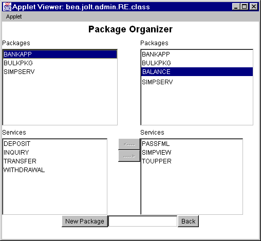

When you need to add a new group of services, you create a new package before adding the services. The Package Organizer Window and the following procedure show how to add a new package, BALANCE, to the Packages listing.
Instructions for Adding a Package
For a description of contents of this window, see Package Organizer Window Description.
The text field is activated.
The new name (shown in the preceding figure as BALANCE) is displayed on the Packages list in random order.

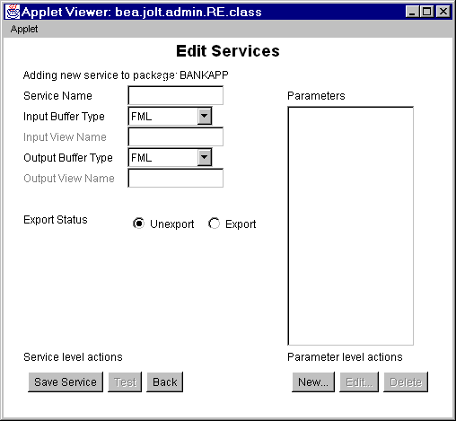

The following figure shows the Edit New Services window for adding a service.
Edit Services Window: Add a New Service to a Package
Adding a Service Window Description The following table describes the options for adding services to a package in a package window.
Instructions for Adding a Service
The Services window opens, similar to the figure shown in Sample Services Window.
If you later decide that another package should contain the new service, use the Package Organizer to move the service to a different package. (See Grouping Services Using the Package Organizer for additional information.)

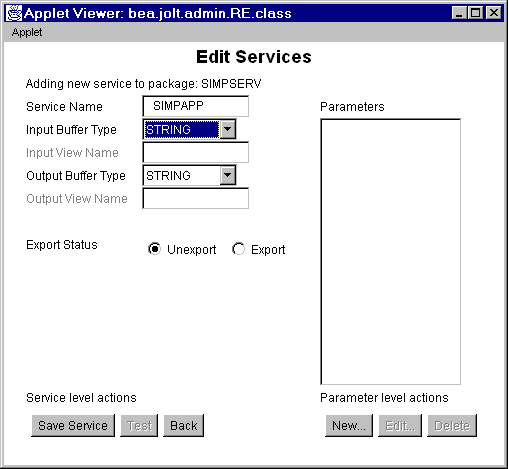

Although the same buffer type selected for the Input Buffer is automatically selected for the Output Buffer, you can select a different Output Buffer type.
Selecting CARRAY or STRING as a Service Buffer Type
If CARRAY or STRING is selected as the buffer type for a new service, only CARRAY or STRING can be added as the data type for the accompanying parameters. See also Adding a Parameter and Selecting CARRAY or STRING as a Parameter Data Type. For additional information, refer to Chapter 5, "Using the Jolt Class Library.".
The following figure shows an example Edit Services window with STRING selected as the buffer type for the service SIMPAPP.
Edit Services Window: Select STRING Buffer Type

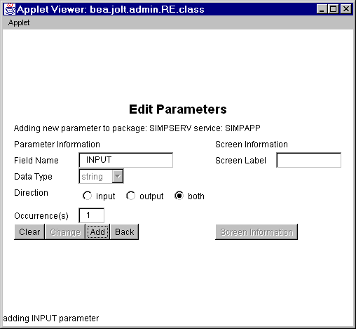

Adding a Parameter Clicking New under the label Parameter level actions in the Edit Services window is displayed in the Edit Parameters window. Review the features in the following figure. Use this window to enter the parameter and screen information for a service. Edit Parameters Window: Add a Parameter
Adding a Parameter Window Description
Instructions for Adding a Parameter
Note: If the buffer type is FML or VIEW, the field name must match the corresponding parameter field name in FML or VIEW.
Warning:
If you do not click Save Service before you click Back, the parameters are not saved as part of the service.

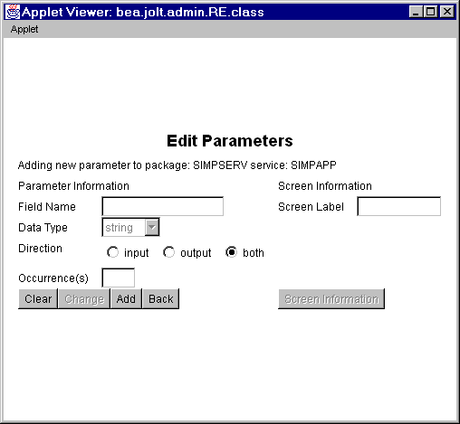

If CARRAY or STRING is the selected buffer type for a new service, only CARRAY or string can be added as the data type for the accompanying parameters.
In this case, only one parameter can be added. It is recommended that you use the parameter name "CARRAY" for a CARRAY buffer type, and the parameter name "STRING" for a STRING buffer type.
See also Instructions for Adding a Service and Selecting CARRAY or STRING as a Service Buffer Type. For additional information, refer to Chapter 5, "Using the Jolt Class Library.".
The following figure is an example of the Edit Parameters window with string as the selected data type for the parameter. The Data Type defaults to string and does not allow you to modify that particular data type. The Field Name can be any name.
Edit Parameters Window: string Data Type
