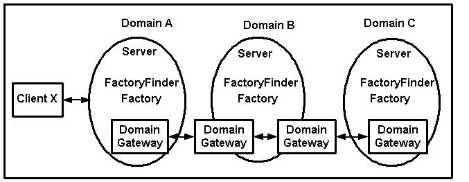

Interdomain Communication
Figure 9-1 shows a simple multiple-domain configuration.
Figure 9-1 Multiple-domain Configuration

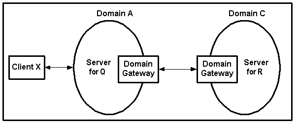

The following steps describe single-domain communication between Client X and Domain A:
  1. Client X connects to Domain A using the Bootstrap object. The client application uses the Bootstrap object to locate a FactoryFinder and then uses the FactoryFinder to ask for a factory for objects of type Q. (The FactoryFinder call is itself an invocation on Domain A.)
  2. When the FactoryFinder returns a factory, the client then invokes that factory in Domain A.
  3. The factory returns a reference to an object of type Q, called Q1.
  4. The client now invokes on object Q1 in Domain A.
    Note: Throughout all of these steps, the client does not know where any of the objects are, or which domains they are in. It might not even know that there is something called a domain. The administrative actions for connecting a client to Domain A are relatively simple for a client, because the client is a simple machine and has very little infrastructure; it stands alone for the most part. Indeed, the connection to a WebLogic Enterprise domain is the primary administration for a client. The actual administrative chore is setting the address of the ISL that is in Domain A.
For multiple-domain communication, Q1 needs the services of Object R1, which is in Domain C; therefore, object Q1 must execute operations similar to those described in steps 1 through 4 above, but across domain boundaries. The actual steps are as follows:
  1. Object Q1 uses a Bootstrap object to locate a FactoryFinder and then uses the FactoryFinder to ask for a factory for objects of type R.
  2. When the FactoryFinder returns a reference to a factory in Domain C, Object Q1 invokes that factory.
  3. The factory returns a reference to an object of type R, called R1.
  4. Object Q1 invokes on Object R1.
    Note: As with Client X, there must be some administration to allow Object Q1 to get at the factories and objects in Domain C. As Figure 9-1 shows, the mechanism for communication between domains is a domain gateway. A domain gateway is a system server in a domain. A system server is different than a user-written server because it is provided as part of the WebLogic Enterprise product; other system servers are the name servers, FactoryFinders, and ISLs. A domain gateway is somewhat similar in concept to an ISL because it is the "contact" point for a domain. It is different from an ISL, however, because a domain gateway connects to another domain gateway, which is itself a contact point for a domain; that is, a domain gateway's job is to connect to another domain gateway. Thus, the pair of domain gateways cooperate to make sure that invocation on objects that inhabit different domains are routed to the correct domain.
For domain gateways to operate in this manner, they must be configured properly. That configuration is the subject of the following sections.

When using the multiple domains feature, you can configure two types of configurations: directly connected domains and indirectly connected domains. You, as the administrator, configure both types using the domain configuration file, DMCONFIG.
Directly Connected Domains
It is possible for every domain in an enterprise to have a gateway to every other domain it might use. Such a configuration has the advantage that a request goes directly to the target domain, with the minimum of delay. Such an "n-way" configuration is quite reasonable when the number of domains is small, but each new domain requires two new gateways. At some point, an administrator may consider a different configuration, giving up speed of delivery for ease of management of domain connections. This is when the ability to configure indirectly connected domains becomes advantageous.
Indirectly Connected Domains
An administrator should consider what the likely traffic patterns are. Domains that have only occasional interactions are candidates for gateway removal. Since there will still be interactions, it must still be possible to reach the other domain. The technique used is to route the request through an intermediate domain that does have direct access to the target domain. For example, we might have three domains, A, B, and C. Domains A and B are directly connected and domains B and C are directly connected, but A and C are not directly connected (See Figure 9-2). For domains A and C to communicate, they must use domain B as the intermediary. Therefore, the DMCONFIG file for domain A must state that it is possible to connect to domain C by going through domain B (and vice versa). That is, the connectivity is:
Domains A <-> B <-> C
Gateways GAB GBA GBC GCB
Domain A has a gateway process, GAB (the Gateway from A to B), that connects to domain B. The domain A DMCONFIG file states that GAB acts as a gateway to two domains, domains B and C. The DMCONFIG file for domain C has a similar configuration, stating that GCB is connected to B and A. The DMCONFIG file for domain B has two gateway processes, one which connects to A (GBA) and one which connects to C (GBC). This is called an indirect connection.
Given this indirect connection, when a server in A invokes a request on an object in C, WLE knows that it can send the request to gateway GAB. The WLE gateway does not know that its partner gateway in B cannot service the request itself, but that is acceptable. Once the request is in domain B, it is routed through GBC to C, which can service the request. Thus, the request is serviced with one extra hop.
It is even possible for the two gateways in domain B to be a single gateway, so that there is not an extra hop within B. In effect, the same processing occurs in domain B, but it all occurs within a single gateway process.
Figure 9-2 Indirectly Connected Domains
