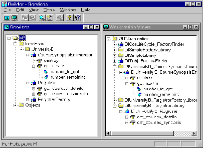

The Application Builder is the development tool that creates ActiveX views of CORBA objects. The Application Builder is the primary user interface to the BEA ActiveX Client. It can be used to select which CORBA objects are available to desktop applications, to create ActiveX views of the CORBA objects, and to create packages for deploying ActiveX views of CORBA objects to client machines.
To use an ActiveX view, you load the interfaces of the CORBA objects into the Interface Repository. You then create an ActiveX binding for the CORBA interface. The binding describes the interface of a CORBA object to ActiveX. The combination of the ActiveX client application and the generated binding creates the view of the object.
As shown in Figure 3-1, the Application Builder main window is partitioned into two parts: the Services window and the Workstation Views window.
The Services window presents all the CORBA modules, interfaces, and operations contained in the Interface Repository in the local WLE domain (referred to as the M3 domain in the BEA Application Builder software that is installed as part of the WLE V4.2 software kit). You can create bindings for all the interfaces in the Interface Repository.
At the top of the Services window are entries for each object system that is available from the WLE domain. The ActiveX Client supports only the WLE object system. The objects are displayed in the same hierarchical format used in the Interface Repository, that is, as modules, interfaces, operations, and the parameters contained in operations. The [+] symbol indicates an object that can be expanded to display the other objects.
The Workstation Views window presents all the ActiveX bindings that have been created for CORBA interfaces. To create a binding for a CORBA interface, you drag an entry from the Services window and into the Workstation Views window.

The BEA Application Builder
Figure 3-1 Application Builder Main Window
