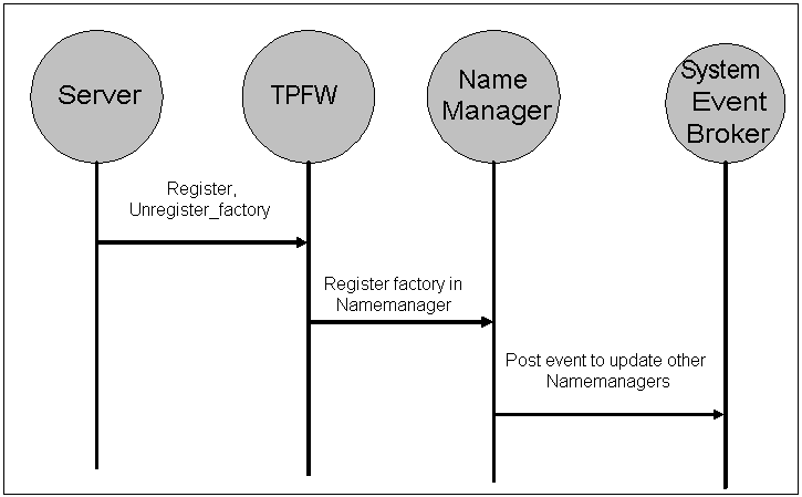

Registering a Factory
TP::register_factory
operation, once a reference to a factory object has been created. The reference to the factory object, along with a value that identifies the factory, is passed to this operation. The registration of references to factory objects is typically done as part of initialization of the application (normally as part of the implementation of the operation Server::initialize)
Figure 5-1 Registering a Factory Object
TP::unregister_factory
operation. Once unregistered, the reference to the factory object can then be destroyed. The process of unregistering a factory with the FactoryFinder is typically done as part of the implementation of the Server::release
operation. For more information about these operations, see the section "Server Interface" on page 3-24.

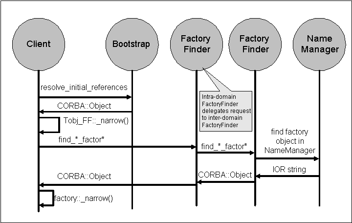

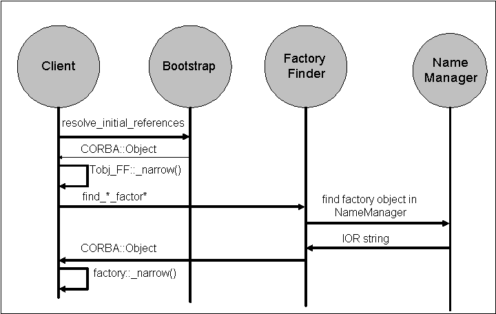

For a client application to request a factory to create a reference to an object, it must first obtain a reference to the factory object. The reference to the factory object is obtained by querying a FactoryFinder with specific selection criteria (see Figure 5-2). The criteria are determined by the format of the particular FactoryFinder interface and method used.
Figure 5-2 Locating a Factory Object
The WLE software extends the CosLifeCycle::FactoryFinder
interface by introducing four methods in addition to the find_factories()
method declared for the FactoryFinder. Therefore, using the Tobj extensions, a client can use either the find_factories(
) or find_factories_by_id()
methods to obtain a list of application factories. A client can also use the find_one_factory
() or find_one_factory_by_id
() method to obtain a single application factory, and list_factories ()
to obtain a list of all registered factories.

Typically, a FactoryFinder returns references to factory objects that are in the same domain as the FactoryFinder itself. However, it is possible to return references to factory objects in domains other than the domain in which a FactoryFinder exists. This can occur if a FactoryFinder contains information about factories that are resident in another domain (See Figure 5-3). A FactoryFinder finds out about these interdomain factory objects through configuration information that describes the location of these other factory objects.
When a FactoryFinder receives a request to locate a factory object, it must first determine if a reference to a factory object that meets the specified criteria exists. If there is registration information for a factory object that matches the criteria, the FactoryFinder must then determine if the factory object is local to the current domain or needs to be imported from another domain. If the factory object is from the local domain, the FactoryFinder returns the reference to the factory object to the client.
Figure 5-3 Inter-Domain FactoryFinder Interaction
If, on the other hand, the information indicates that the actual factory object is from another domain, the FactoryFinder delegates the request to an interdomain FactoryFinder in the appropriate domain. As a result, only a FactoryFinder in the same domain as the factory object will contain an actual reference to the factory object. The interdomain FactoryFinder is responsible for returning the reference of the factory object to the local FactoryFinder, which subsequently returns it to the client.
