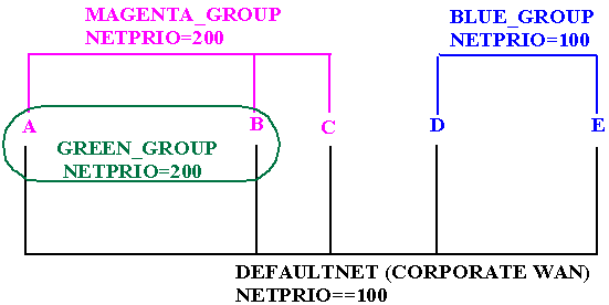

The hypothetical First State Bank has a network of five machines (A-E). It serves the bank's business best to have four network groups and to have each machine belong to two or three of the four groups.
Note: Configuration of multiple NETGROUPS has both hardware and system software prerequisites that are beyond the scope of this document. For example, NETGROUPS commonly requires machines with more than one directly attached network. Each TCP/IP symbolic address must be identified in the /etc/hosts file or in the DNS (Domain Name Services). In the example that follows, addresses in the form "//A_CORPORATE:5345 " assume that the string "A_CORPORATE " is in the /etc/hosts file or in DNS.
The four groups in the First State Bank example are as follows:
All machines belong to DEFAULTNET (the corporate WAN). In addition, each machine is associated with either the MAGENTA_GROUP or the BLUE_GROUP . Finally, some machines in the MAGENTA_GROUP also belong to the GREEN_GROUP . Figure 6-1 illustrates group assignments for the network.
Figure 6-1 Example of a Network Grouping
In this example, machines A and B have addresses for the following:
Machine C has addresses for the following:
Machines D and E have addresses for the following:
Because the local area networks are not routed among the locations, machine D (in the BLUE_GROUP LAN) may contact machine A (in the GREEN_GROUP LAN) only by using the single address they have in common: the corporate WAN network address.

Assigning Priorities for Each Network Group
Appropriately assigning priorities for each NETGROUP enables you to maximize the capability of network BRIDGE processes. When determining your NETGROUP priorities, keep in mind the following considerations:
Figure 6-2 illustrates how the First State Bank administrator can assign priorities to the network groups.
Figure 6-2 Assigning Priorities to Network Groups
The UBBCONFIG Example Considerations
You can specify the value of NETPRIO for DEFAULTNET just as you do for any other netgroup. If you do not specify a NETPRIO for DEFAULTNET , a default of 100 is used, as in the following example:
*NETGROUP
DEFAULTNET NETGRPNO = 0 NETPRIO = 100
For DEFAULTNET , the value of the network group number must be zero; any other number is invalid. If the BLUE_GROUP 's network priority is commented out, the priority defaults to 100. Network group number entries are unique. Some of the network priority values are equal, as in the case of MAGENTA_GROUP and GREEN_GROUP (200).
Each network address is associated by default with the network group, DEFAULTNET . It may be specified explicitly for uniformity or to associate the network address with another netgroup.
*NETWORK
D NETGROUP=BLUE_GROUP NADDR="//D_BLUE:5726"
In this case, MAGENTA_GROUP and GREEN_GROUP have the same network priority of 200. Note that a lower priority network, such as DEFAULTNET , could be a charge-per-minute satellite link.

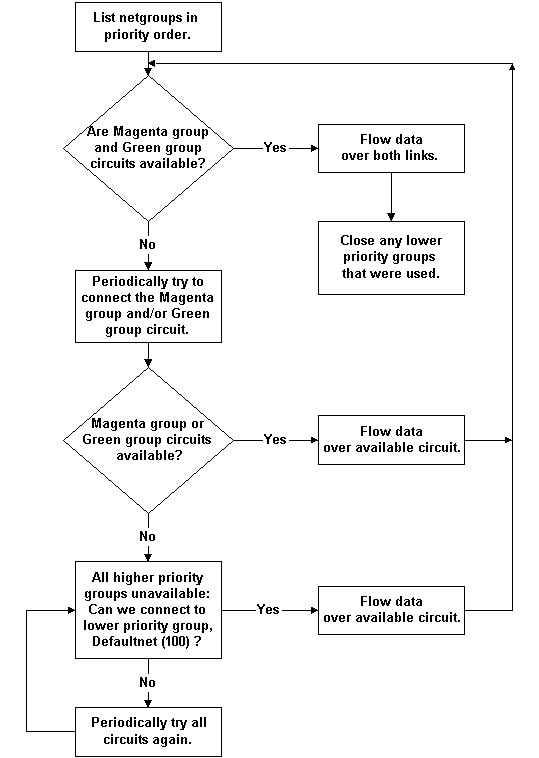

Scheduling Network Data Over Parallel Data Circuits
If you have configured a networked application that uses parallel data circuits, scheduling network data proceeds as follows:
Figure 6-3 is a flow diagram that illustrates how the BRIDGE processes data by priority.
Figure 6-3 Flow of Data over the BRIDGE
Figure 6-3 illustrates the flow of data when machine A attempts to contact machine B. First, the BRIDGE determines which network groups are common to both machine A and machine B. They are the MAGENTA_GROUP , the GREEN_GROUP , and the DEFAULTNET .
The highest priority network addresses originate from the network groups with the highest network priority. Network groups with the same NETPRIO value flow network data in parallel. All network groups with a higher priority than that of the network groups that are flowing data are retried periodically.
Once network connections have been established with different NETPRIO values, no further data is scheduled for the lower priority connection. The lower priority connection is disconnected in an orderly fashion.
Network Data in Failover and Failback
Data flows over the highest available priority circuit. If network groups have the same priority, data travels over all networks simultaneously. If all circuits at the current priority fail, data is sent over the next lower priority circuit. This is called failover.
When a higher priority circuit becomes available, data flow is restored to the higher priority circuit. This is called failback.
All unavailable higher priority circuits are retried periodically. After connections to all network addresses have been tried and have failed, connections are tried again the next time data needs to be sent between machines.
