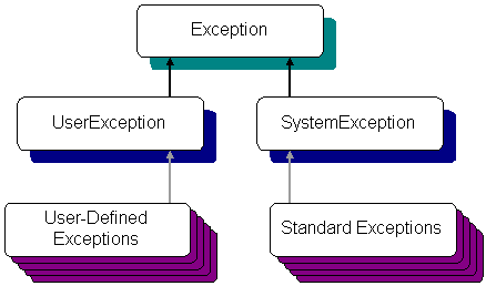

Since both system and user exceptions require similar functionality, the SystemException
and UserException
classes are derived from the common Exception
class. When an exception is raised, your client application can narrow from the Exception
class to a specific SystemException
or UserException
class. The C++ Exception inheritance hierarchy is shown in Figure 7-1.
The Exception
class provides the following public operations:
CORBA C++ Client Applications
Figure 7-1 C++ Exception Inheritance Hierarchy
The copy constructor
and destructor
operations automatically manage the storage associated with the exception.

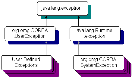

Figure 7-2 shows the inheritance hierarchy of the Java Exception classes.
The standard OMG IDL system exceptions are mapped to final Java classes that extend org.omg.CORBA.SystemException
and provide access to the OMG IDL major and minor exception code, as well as a string describing the reason for the exception.
There are no public constructors for org.omg.CORBA.SystemException
; only classes that extend it can be instantiated.
The Java class name for each standard OMG IDL exception is the same as its OMG IDL name and is declared to be in the org.omg.CORBA
package. For example, the CORBA-defined system exception BAD_CONTEXT
maps to Java as org.omg.CORBA.BAD_CONTEXT
. The default constructor supplies zero for the minor code, COMPLETED_NO
for the completion code, and ""
for the reason string. There is also a constructor that takes the reason and uses defaults for the other fields, as well as a constructor that requires all three parameters to be specified.
