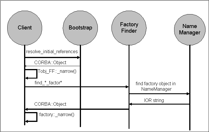

In the CORBA FactoryFinder model, application servers register active factories with a FactoryFinder. When an application server's factory becomes inactive, the application server removes the corresponding registration from the FactoryFinder. Client applications locate factories by querying a FactoryFinder. The client application can control the references to the factory object returned by specifying criteria that is used to select one or more references.
A client application must obtain a reference to a FactoryFinder before it can begin locating an appropriate factory. To obtain a reference to a FactoryFinder in the domain to which a client application is associated, the client application must invoke the Tobj_Bootstrap::resolve_initial_references
operation with a value of "FactoryFinder"
. This operation returns a reference to a FactoryFinder that is in the domain to which the client application is currently attached. For more information, see the section "Tobj_Bootstrap::register_callback_port" on page 4-19.
The references to the FactoryFinder that are returned to the client application can be references to factory objects that are registered on the same machine as the FactoryFinder, on a different machine than the FactoryFinder, or possibly in a different domain than the FactoryFinder.

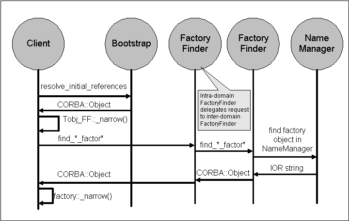

Typically, a FactoryFinder returns references to factory objects that are in the same domain as the FactoryFinder itself. However, it is possible to return references to factory objects in domains other than the domain in which a FactoryFinder exists. This can occur if a FactoryFinder contains information about factories that are resident in another domain (See Figure 5-3). A FactoryFinder finds out about these interdomain factory objects through configuration information that describes the location of these other factory objects.
When a FactoryFinder receives a request to locate a factory object, it must first determine if a reference to a factory object that meets the specified criteria exists. If there is registration information for a factory object that matches the criteria, the FactoryFinder must then determine if the factory object is local to the current domain or needs to be imported from another domain. If the factory object is from the local domain, the FactoryFinder returns the reference to the factory object to the client.
If, on the other hand, the information indicates that the actual factory object is from another domain, the FactoryFinder delegates the request to an interdomain FactoryFinder in the appropriate domain. As a result, only a FactoryFinder in the same domain as the factory object will contain an actual reference to the factory object. The interdomain FactoryFinder is responsible for returning the reference of the factory object to the local FactoryFinder, which subsequently returns it to the client.

Obtaining a Reference to a FactoryFinder Object Using the CosLifeCycle::FactoryFinder Interface
The following code fragment (Listing 5-9) shows how to use of the CORBA-compliant interface to obtain one or more references to factory objects.
Listing 5-9 Client Application: Getting a FactoryFinder Object Reference
// Client Application: Obtaining the object reference
// to factory objects.CosLifeCycle::Key_var factory_key = new CosLifeCycle::Key( );
factory_key ->length(1);
factory_key[0].id = string_dupalloc( "strlen("TellerFactory") +1 );
factory_key[0].kind = string_dupalloc(
strlen(""FactoryInterface") + 1);
strcpy( factory_key[0].id, ""TellerFactory" );
strcpy( facory_key[0].kind, "FactoryInterface" );
CosLifeCycle::Factories_var * flp = ff_np ->
find_factories( factory_key.in( ) );
Obtaining a Reference to a FactoryFinder Object Using the WLE Extensions Bootstrap object
The following code fragment (Listing 5-10) shows how to use of the WLE extensions Bootstrap object to obtain a reference to a FactoryFinder object.
Listing 5-10 Client Application: Finding One Factory Using the Tobj Approach
// Client Application: Finding one factory using the Tobj
// approach.Tobj_Bootstrap * bsp = new Tobj_Bootstrap(
orb_ptr.in( ), host_port );
CORBA::Object_varptr ff_op = bsp ->
resolve_initial_references( "FactoryFinder" );
Tobj::FactoryFinder_ptrvar ff_np =
Tobj::FactoryFinder::_narrow( ff_op);
Using WLE Extensions to the FactoryFinder Object
