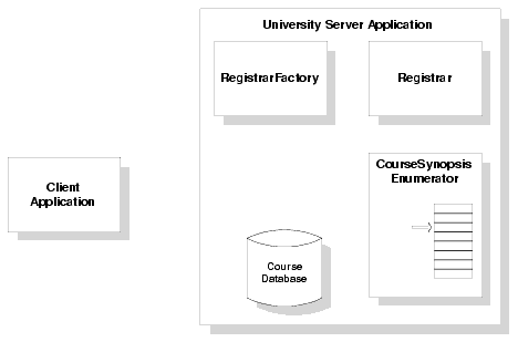

The Basic University sample application is shown in Figure 3-1.
For the purposes of explaining what happens when the Basic University sample application runs, the following separate groups of events are described:
Figure 3-1 Basic University Sample Application
The following sequence shows a typical set of events that take place when the Basic client and server applications are started and the client application obtains an object reference to the Registrar
object:
Application Startup
The following sequence traces the events that may occur when the student browses a list of course synopses:
To create the object reference CourseSynopsisEnumerator object, the Registrar object does the following:
(If the number_remaining variable is 0, the Registrar object invokes the destroy() operation on the CourseSynopsisEnumerator object and returns a nil reference to the client application.)
The following sequence shows a typical set of events that take place when the client application browses course details:
