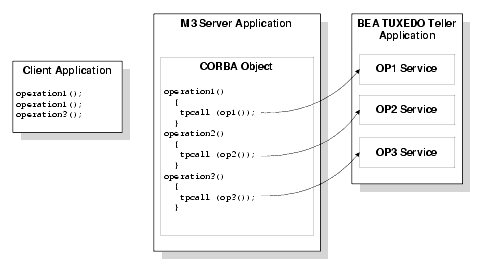

The following figure shows a high-level view of the relationship among the client application, the CORBA object managed by the WLE server application, and the BEA Tuxedo application that implements the services called from the CORBA object.

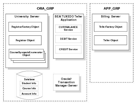

This section describes the design for the Wrapper sample application, which incorporates an additional server application, Billing, into the configuration. Therefore, the Wrapper sample application consists of the following four server applications:
Design Considerations for the Wrapper Sample Application
In addition, the UBBCONFIG
file for the Wrapper sample application specifies the following groups:
The configuration of the WLE domain in the Wrapper sample application is shown in the following figure.
