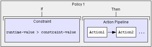

Each WLOC policy consists of a constraint and an action or action pipeline. The constraint defines some deployment or runtime requirement of a service, while the action or action pipeline defines one more actions to take if the service runtime-value is outside the constraint-value range.
For example, a policy could consist of a constraint that defines a runtime requirement of at least two running processes and an action that starts a process if only one is found to be running.
Figure 6-1 illustrates the basic constraint/action relationship.
Figure 6-1 Policy Constraint and Actions
The assignment of a constraint and action to a policy is referred to as the ‘constraint/action binding’.

Action Pipelines
Actions can be combined into action pipelines so that a sequence of actions takes place when a constraint is violated.
Note: If an action fails at any point in the pipeline, the pipeline terminates and no subsequent actions in the pipeline are executed.
Action Pipeline Example
To define the actions needed to start a WebLogic Server Admin Server instance, then start a cluster of Managed Server instances, and then send an email notification, you would do the following:
  1. Define an action that starts the WLS Admin Server instance.
  2. Define an action that starts the Managed Server instances.
  3. Define an action that sends e-mail notification when the server instances start up.
  4. Define an action pipeline that consists of all these actions.
  5. Create a policy with an appropriate constraint and bind the pipeline to the constraint.
