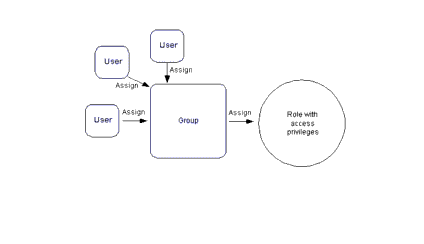

A user is an entity that can be authenticated. WLOC uses password authentication only. A group is a collection of users who usually have something in common, such as working in the same department in a company. For efficient security management, BEA recommends that instead of adding users directly to security roles, you add users to groups and then you assign groups to security roles.
Table 7-1 describes WLOC security groups and the out-of-box security role assignment for the group. You may create additional groups, but may not create additional security roles. You can indirectly create a scoped service admin role by creating a service; when you create a new service, a security role is created to administer that service.

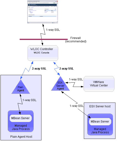

To secure communications between WLOC, managed endpoints, and the infrastructure that hosts the endpoints, WLOC uses 1-way or 2-way SSL. It assumes that you have configured perimeter security measures (e.g., firewalls) and restricted access to the host and its filesystem to trusted users.
Figure 7-2 summarizes security for WLOC communication.

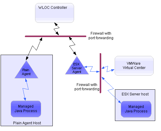

BEA recommends that you place the Controller and all Agents behind the same firewall whenever possible (see Figure 7-2). Controllers and Agents communicate only through HTTPS if secure communications is enabled. In this communication, the Controller always initiates communication by sending a request and the Agent returns a response. Once the Controller has initiated a connection to the Agent and the Agent responds, either the Agent or the Controller can initiate an HTTPS connection.
If you place Controllers and Agents behind separate firewalls, you must configure the firewall to open at least one HTTPS communication channel. In addition, you must configure port forwarding for each Agent behind the firewall. In such an environment, the Controller sends requests to the firewall and the firewall forwards each request to the appropriate Agent. See Figure 7-3.
Similarly, Agents use one-way protocols (HTTPS or IIOPS) to communicate with hypervisor software and with managed processes. If you use a firewall to separate Agents from hypervisor software and managed processes, you must configure the firewall to forward requests from the Agent to the hypervisor software and managed processes.
Communication between the Web browser and the WLOC Administration Console is secured using 1-way SSL. In this communication:
controller) is included in the keystore. See Keystores.
To enable secure communication between the Administration Console and the Controller, set the Controller’s Console Security Mode to SECURE or BOTH. This can be set when running the configuration wizard. In addition, it can be changed using Administration Console on the Networking tab or by modifying the <console-mode> element in loc-controller-config.xml.
The Controller uses a separate SSL connection to communicate with each Agent using 2-way SSL over HTTPS. In this communication the Controller is the SSL client and each Agent is a SSL server.
To enable secure connections between a Controller-Agent connections:
While the use of 2-way SSL prevents potential attackers from snooping communications, an Agent’s Web Services interface does not require authorization. An Agent assumes that once an SSL connection is established, the caller is trustworthy. To prevent unauthorized use of WLOC Agents, ensure that all Agents are behind a firewall and that secure communications between the Controller and Agent is enabled.
“Unsecure’ connections can be used in testing or other environments that do not require encryption. Be aware, however, that this would allow an attacker to directly access all Agent and Controller functions without any constraints.

All communications between Agents and Virtual Center are secured using 1-way SSL. In this communication the Agent is the SSL client and Virtual Center is the SSL server. To enable SSL, the Virtual Center’s certificate must be imported into the Agent’s internal trust keystore.

An Agent communicates with MBean Servers using IIOPS over a 1-way SSL connection. In this communication, the Agent is the SSL client and the MBean server is the SSL server. The managed process provides a certificate which you import into the managing Agent’s internal trust keystore.
In addition, MBean Servers are usually configured to require authentication using a user name and password as credentials. (WebLogic Server MBean Servers always require authentication and authorization.)

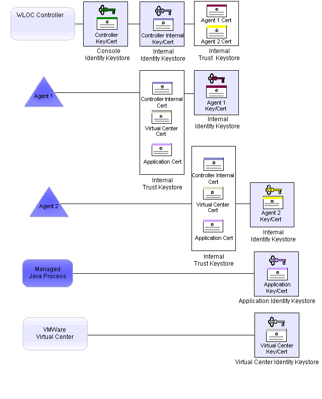

For secure communications, WLOC uses Java keystores that are distributed throughout the environment. The WLOC Configuration Wizard creates all WLOC keystores and populates the identity keystores with private keys and self-signed certificates. The self-signed certificates are also available as pem files outside of the identity keystores, so they can be imported into the corresponding trust keystores.
You populate the trust keystores. Managed processes and hypervisor software provide their own identity keystores. WLOC does not create keystores for managed processes and hypervisor software. See Figure 7-4.
To support 1-way SSL between Web browsers and the WLOC Administration Console, the Controller uses the Console Identity Keystore. To support 2-way SSL between the Controller and each Agent, the Controller uses the Controller Internal Identity Keystore and Controller Internal Trust Keystore.
The console identity keystore contains the private key and self-signed certificate that supports 1-way SSL communication between a Web browser and the WLOC Administration Console application. When a user initiates a session with the WLOC Administration Console application, the Web browser prompts the user to trust the Controller's certificate.
controlleridentity.jks and is located in CONTROLLER_HOME/ssl where CONTROLLER_HOME is the directory in which you install the Controller. controller and contains the name of the host on which the Controller is installed. It has a key size of 1024 and a private key type of RSA with a signature algorithm of MD5withRSA. It expires in 10958 days (30 years).controller.
The keystore is named internalidentity.jks and is located in CONTROLLER_HOME\ssl\internal where CONTROLLER_HOME is the directory in which you install the Controller.
The certificate in this keystore is saved under the alias controllerinternal and contains the name of the host on which the Controller is installed. It has a key size of 1024 and a private key type of RSA with a signature algorithm of MD5withRSA. It expires in 10958 days (30 years).
Access to the keystore via the JDK keystore tools is protected by a password. You specify the password when running the configuration wizard. The password is stored as an encrypted string in the Controller’s configuration document. While this keystore is not intended to be modified, you can use the JDK keystore tools to read the certificate values.
The Controller’s internal trust keystore contains a copy of each Agent’s self-signed certificate. (Note that WLOC does not support the use of CA certificates in its internal trust keystores.) These certificates are required to support 2-way SSL communication between the Controller and all Agents.
The WLOC Configuration Wizard creates this keystore, but does not populate it with Agent identities. This is accomplished as described in Importing an Agent Identity into the Controller Trust Keystore.
The keystore is named internaltrust.jks and is located in CONTROLLER_DIR\ssl\internal where CONTROLLER_DIR is the directory in which you install the Controller.
To support 2-way SSL between an Agent and the Controller, as well as 1-way SSL between an Agent and managed processes and between an Agent and VMware Virtual Center, an Agent uses its Agent Identity Keystore and Agent Internal Trust Keystore.
An Agent’s identity keystore contains the private key and self-signed certificate that supports 2-way SSL communication between the Agent and the Controller.
The WLOC Configuration Wizard creates this keystore as well as the private key and self-signed certificate. You cannot replace or modify the key or certificate in this keystore.
The keystore is named internalidentity.jks and is located in AGENT_DIR\ssl\internal where AGENT_DIR is the directory in which you install an Agent.
The certificate in this keystore is saved under the alias agentinternal and contains the name of the host on which the Agent is installed. It has a key size of 1024 and a private key type of RSA with a signature algorithm of MD5withRSA. It expires in 10958 days (30 years).
Access to the keystore via the JDK keystore tools is protected by a password. You specify the password when you configure the Agent. The password is stored as an encrypted string in the Agent’s configuration XML document.
An Agent’s internal trust keystore contains a copy of the Controller’s self-signed certificate, as well as a copy of the CA certificates of the processes that it manages. A Hypervisor Agent also contains a copy of the VMware Virtual Center CA certificate. These certificates are required to support 2-way SSL communication between the Agent and Controller, as well as 1-way SSL between an Agent and managed processes and between an Agent and VMware Virtual Center.
The WLOC Configuration Wizard creates this keystore when you configure an Agent. It is named internaltrust.jks and is located in AGENT_HOME\ssl\internal where AGENT_HOME is the directory in which you install an Agent.
To import the Controller’s identity into the keystore, see Importing the Controller Identity into an Agent Trust Keystore. To import the Virtual Center’s identity into an ESX Agent’s keystore, see Importing the Virtual Center Identity into an Agent Trust Keystore.
