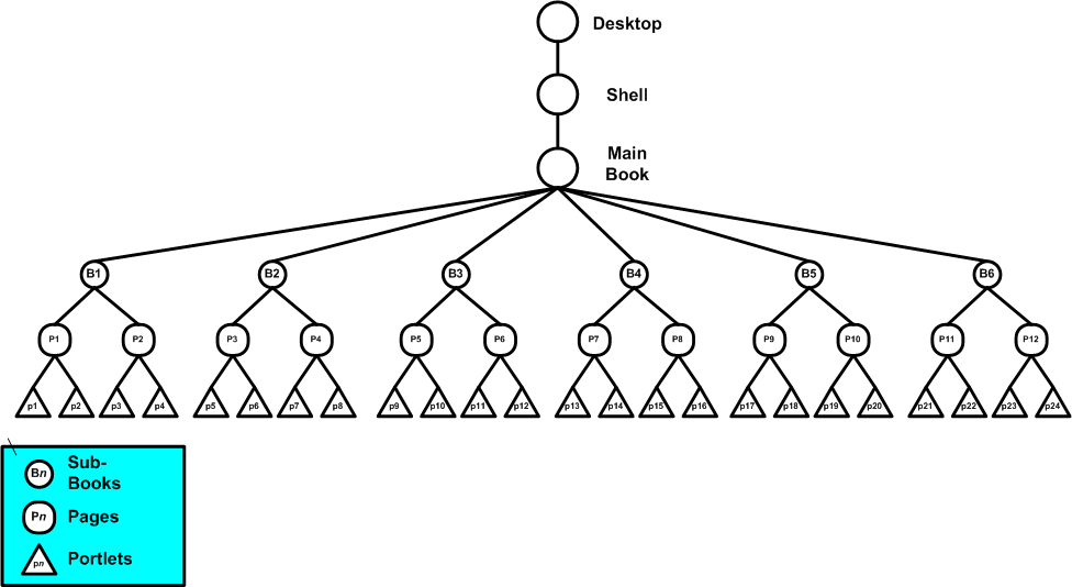

When a portal is instantiated, it generates a taxonomy, or hierarchy of portal resources, such as desktops, books, pages, and portlets. Each resource is represented as a node on the control tree, as shown in Figure 1.
Figure 1 Simple Portal Schematic
This example depicts a single portal with a main book containing six sub-books, which in turn contain two pages each, and each page contains two portlets each, for a minimum of 42 controls in the portal; the inclusion of buttons, windows, menus, and layouts will increase the number of controls on the portal significantly.
Note: This example is significantly oversimplified; enterprise portals might include thousands of controls.

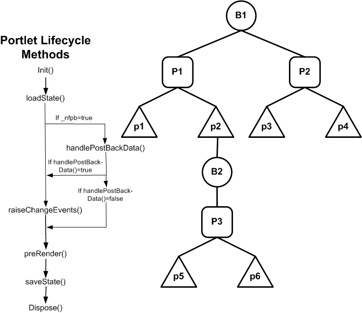

Once the control tree is built and all the instance variables are set on the controls, the tree must run through the lifecycle for each control before the portal can be fully-rendered. The lifecycle methods are called in depth-first order. That is, all the init()
methods for each control are called, followed by the loadState()
method for each control, and so on in an order determined by the position of each control in the portal's taxonomy. For example, the control tree illustrated in Figure 2 depicts the taxonomy a simple portal comprised of a book (B1) containing two pages (P1 and P2), which each contain two portlets (p1-p4; note that p2 also contains its own subordinate book, page, and portlet hierarchy).
Figure 2 Control Tree with Lifecyle Methods
When this portal is rendered, the init()
method (and handlePostBackData()
if _nfpb=true
) will be called first, for each control, in this order: B1, P1, p1, p2, B2, P3, p5, p6, P2, p3, and finally p4. Next, the loadState()
method would be called in the same order, and so on for all lifecyle methods through saveState()
Note: Control lifecycle methods preRender()
, render()
, and dispose()
are called only on visible controls.

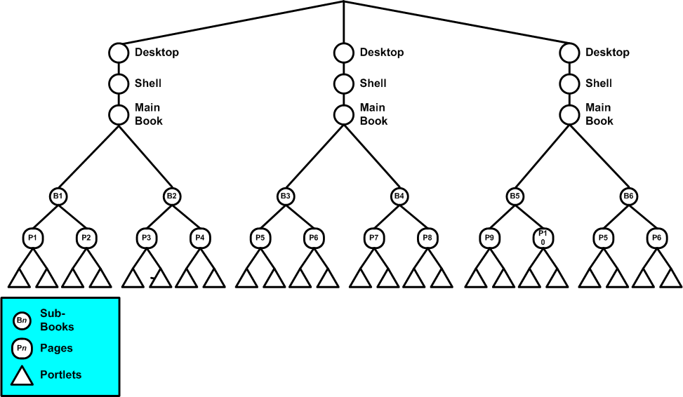

With SP3 and earlier versions of WebLogic Portal, the simplest way to limit the size of the control tree without limiting the flexibility of the portal is to split the portal into multiple desktops. In portal taxanomics, a desktop is nothing more than a portal embedded into another portal. It maintains the ability to leverage all of the features inherent in any portal and, within itself, can contain additional desktops.

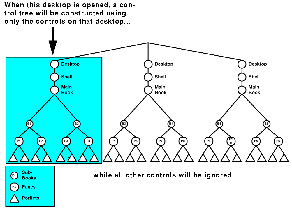

When you split a complex portal into multiple desktops, you spread the controls among those desktops. Since the control tree is scoped to the individual portal and since a desktop behaves much like a portal, each desktop has its own tree and the controls on that tree are built only when that desktop is opened. Thus, by splitting a complex portal with a large control tree into multiple desktops, you reduce the number of controls on the tree to just that number necessary for the active desktop. As you might guess, this will reduce the amount of time required to render the portal as a single desktop and increase portal performance.
When a portal is rendered, about 15% of the processing time is dedicated to constructing the control tree, 70% to running the lifecycle methods, and 15% in garbage collection (clearing dead objects from the heap, thus releasing that space for new objects). While construction and garbage collection are always performed, running the lifecycle methods is only necessary for visible controls (that is, those on the exposed desktop). This results in considerable overhead savings and improved system performance.
For example, the sample control tree depicted in Figure 1 shows a single portal with 42 controls. Were we to split this portal up into multiple desktops, as in Figure 3, while we would increase the number of control trees in the entire portal, each tree would be nearly two thirds smaller, and thus be processed in roughly two-thirds the time, significantly reducing the time required to render the portal.
Figure 3 Simple Portal Split into Multiple Desktops
Figure 4 shows how the example in Figure 3 might be rendered once opened.
Figure 4 How Multiple Desktops Reduces Control Tree Size
As these examples demonstrate, splitting a complex portal into multiple desktops can be very rewarding in terms of improved performance; however, not all portals will benefit from the extra effort required to split them into multiple desktops. Before implementing a portal using multiple desktops, you need to consider some important design decisions. For example:

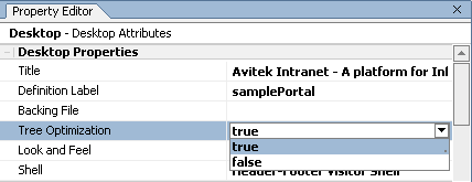

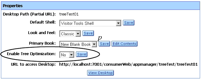

Service Pack 4 of WebLogic Portal 8.1 introduced the concept of control tree optimization. Tree optimization—as the name implies—means that control tree rendering is done in a way that creates the least amount of system overhead while providing the user with as complete a set of portal controls as that user will need to successfully use the portal instance.
You enable control tree optimization by setting the treeOptimizationEnabled
flag in the.portal
file to true, as shown in Listing 1.
Listing 1 Enabling Tree Optimization in .portal
<desktop> element:
<netuix:desktop definitionLabel="defaultDesktopLabel"
markupName="desktop"treeOptimizationEnabled="true"
markupType="Desktop" title="SimplePortal"><netuix:lookAndFeel
definitionLabel="defaultLookAndFeel">
<netuix:desktop/>
Note: If treeOptimizationEnabled=
is not included in the .portal
file, the portal defaults to treeOptimizationEnabled=false
When this flag set to "true"
, the portal framework will generate a partial control tree instead of the full control tree, basing this tree on just the controls that will be visible and active. Thus, with fewer controls needing to be rendered, processing time and expense can be significantly reduced.
Figure 5 Enabling Tree Optimization in WebLogic Workshop
Figure 6 Enabling Tree Optimization from the Administration Portal
Note: For new desktops, treeOptimizationEnabled="true"
is the default value, so you really don't need to set anything in that circumstance.

When the portal servlet receives a request (that is, a mouse-click) it will read the cache to determine if a control tree factory exists. If one doesn't, it calls controlTreeFactoryBuilder
, passing it the XML from the .portal
file. This class returns a control tree factory to the servlet, which passes the request to the CreateUIControlTree
class.
Assuming _pageLabel
and treeOptimizationEnabled="true"
, CreateUIControlTreeFactory
calls the PartialUIControlTreeCreator()
method, which returns a control tree comprised of just the control identified by the page label and the set of active page and book labels; this is a partial control tree.
For example, if tree optimizations were enabled for the portal depicted in Figure 1, when you submit a request (that is, a mouse click), only the active controls would be rendered, as illustrated in Figure 7.
Figure 7 How Tree Optimization Reduces Control Tree Size
The set of active page and book labels for that session stored during the saveState()
lifecycle method execution tell PartialUIControlTreeCreator
() which controls to build. Only these controls will be built; all others in the portal will be ignored. As you can see, a significant amount of processing overhead is eliminated when the control tree is optimized—since far fewer controls need to be built—resulting in greatly improved performance.

At this time, forkPreRenderTimeout is not supported in the WebLogic Workshop interface. To implement it, please refer to the instructions in the topic "How Do I: Enable the forkPreRenderTimeout Attribute?" in the WebLogic Workshop online help system. |
