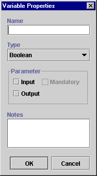

To define a variable:
  1. In the folder tree, right-click Variables under the appropriate workflow template definition, and choose New Variable to display the Variable Properties dialog box.
    Figure 4-1 Variable Properties Dialog Box
  2. Complete the following fields:

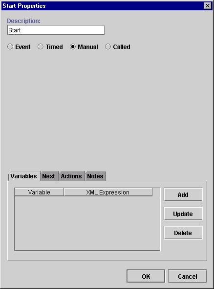

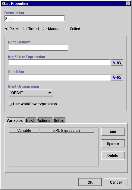

Defining a Start Node
To define a Start shape:
  1. Display or add the Start shape as described in Adding Workflow Components to a Workflow Diagram.
  2. Double-click the Start shape to display the Start Properties dialog box.
    Figure 4-3 Start Properties Dialog Box
  3. The Description field by default contains the name Start. Modify this name as needed to create a unique, identifiable name.
  4. Select a workflow triggering method:
  5. Complete or view the fields on the tabs:

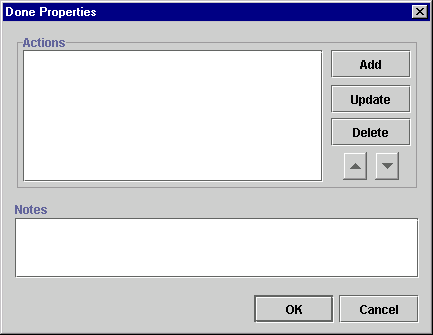

Defining Dones
A done shape represents the point within the workflow where the process completes. Once a done node is reached in the workflow, the running instance of the workflow is marked done, regardless of whether all the done nodes have been reached or not.
You can specify any number of done shapes in a workflow. If a workflow can exit from various points, you have the option of placing separate done nodes wherever needed.
To define a done:
  1. Add or view a done shape as described in Adding Workflow Components to a Workflow Diagram.
  2. Double-click the done shape or right-click it in the folder tree and choose Properties to display the Done Properties dialog box.
    Figure 4-7 Done Properties Dialog Box
  3. Complete or view the fields:

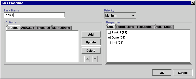

Defining Tasks
A workflow contains a series of tasks, each of which represents a discrete activity to be performed automatically by the WebLogic Process Integrator server or by a workflow user. The task behavior is determined by various task properties and by the task actions that define the processing to be performed as certain task events occur.
To define a task:
  1. Display or add a task as described in Adding Workflow Components to a Workflow Diagram.
  2. Double-click the task shape or right-click the task in the folder tree and choose Properties to display the Task Properties dialog box.
    Figure 4-9 Task Properties Dialog Box
  3. Complete the following fields:
  4. View or provide information on the following tabs:

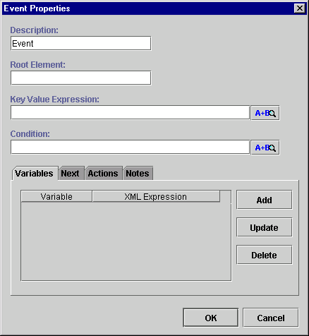

Defining Events
A workflow event shape represents a notification node. The workflow waits for an XML message to trigger the event. Upon that trigger, actions defined within the event can be executed and/or workflow variables can be set.
To define an event:
  2. Double-click the event shape or right-click it in the folder tree and choose the Properties command to display the Event Properties dialog box.
    Figure 4-10 Event Properties
  3. To define the event, follow the procedure in Using the XML Notification: The WebLogic Process Integrator Event in Understanding WebLogic Process Integrator Events and XML Documents.

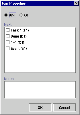

Defining a Join
To define a join:
  1. Display or add a join as described in Adding Workflow Components to a Workflow Diagram.
  2. Double-click the join shape or right-click it in the folder tree and choose Properties to display the Join Properties dialog box.
    Figure 4-11 Join Properties Dialog Box
  3. Complete or view the fields as follows:
