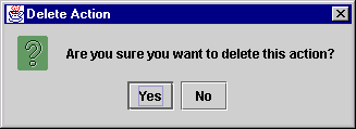

Deleting an Action
To delete an action:
  1. In the workflow diagram, double-click the shape that contains the action you want to delete.
  2. Select the desired action in the Actions section of the Properties dialog box, and click the Delete button. A confirmation dialog box is displayed to prevent accidental deletions.
    Figure 5-3 Delete Action Dialog Box
When an action is deleted, all references to the action are removed. The action is removed from all instances of the workflow, including those currently running.

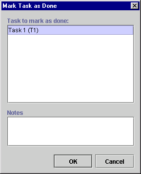

Mark Task as Done
Use this action to set the completion date of a specified task to the current time and mark it done. Executing this action performs all actions found in the MarkedDone tab of the Task Properties dialog box.
When a task is marked as done, the task is no longer listed as an Active task in the Worklist application. By marking a task done, the task is prevented from being executed again, unless the task properties allow it. When a task is marked as done, all successor nodes are activated (as defined in the Task Properties dialog box).
Figure 5-5 Mark Task as Done Dialog Box
View or enter information in the Mark Task as Done dialog box.

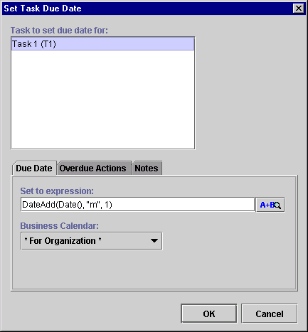

Set Task Due Date
This action sets the due date for a specified task to an interval (expressed in minutes, hours, days, weeks, or months) from when the action is executed, or based on an expression. Subactions can also be specified to be performed when the task becomes overdue.
Figure 5-7 Set Task Due Date Dialog Box
View or enter information in the Set Task Due Date dialog box:
Note: Expressions are built using WebLogic Process Integrator expression syntax and typically use the syntax of XPath function to extract values out of XML documents. If you know the syntax of the expression you want to use, you can type the expression directly in the field. Alternatively, click the A+B button to display the Expression Builder dialog box. The Expression Builder helps you construct an expression, which is made up of functions, operators, literals, and variables. For more information on constructing expressions, see Using Expressions and Conditions.

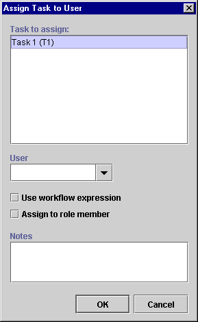

Assign Task to User
Use this action to assign a specified task to an individual user or to a user in a role. The user or role can be specified as a constant or taken from a workflow variable at run time. In the case of a user in a role, the system attempts to perform simple workload balancing in its selection of the assignee; the system determines which user defined to the role has the least number of pending tasks, then assigns the task to that user. Assigning a task to a user causes a notification to be sent to the user. The user views the task from the Worklist application.
Figure 5-8 Assign Task to User Dialog Box
View or enter information in the Assign Task to User dialog box.

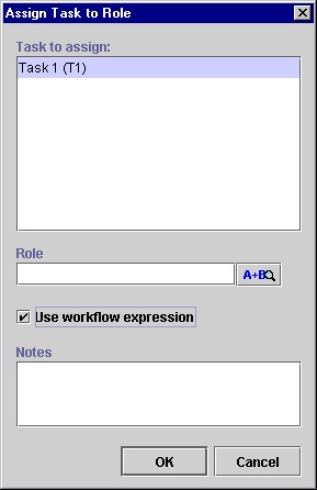

Assign Task to Role
Use this action to assign a task to a role, either directly to a constant role or by taking the value of a workflow expression at run time. It is not always desirable to assign a task to a specific user. When you assign a task to a role, any user that is defined as a member of the role has access to the worklist of the role. When a task is assigned to a role, there is no workflow notification of a new task. Assign a tasks to a role when the task can be performed by anyone who is a member of that role and has a certain skill level.
Figure 5-9 Assign Task to Role Dialog Box
View or enter information in the Assign Task to Role dialog box.

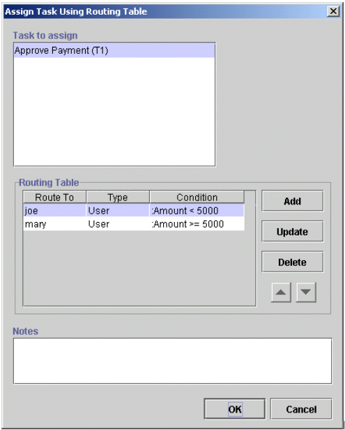

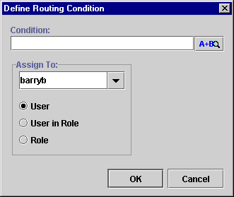

Assign Task Using Routing Table
Assign a task to a user or role depending on a set of conditions. A routing table consists of a sequence of one or more routing conditions. A routing condition specifies a potential assignee (user or role) for the task, together with a specification of the conditions under which the assignment should be made. When the action is executed at run time, the system evaluates each condition in sequence until it encounters one that yields a True result. If such a condition is encountered, the task is assigned to the corresponding user or role, and any subsequent conditions are ignored.
Note: If no routing condition is satisfied, a run-time exception occurs.
Figure 5-10 Assign Task Using Routing Table Dialog Box
View or enter information in the Assign Task Using Routing Table dialog box.
Clicking Add or Update displays the Define Routing Condition dialog box.
Figure 5-11 Define Routing Condition Dialog Box
The Define Routing Condition dialog box contains the following:

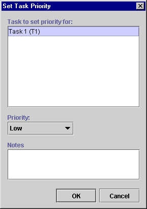

Set Task Priority
Set a task priority to Low, Medium, or High.
Figure 5-14 Set Task Priority Dialog Box
View or enter information in the Set Task Priority dialog box.

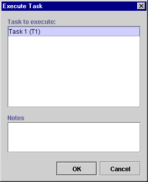

Execute Task
Execute a selected task.
Figure 5-15 Execute Task Dialog Box
View or enter information in the Execute Task dialog box.

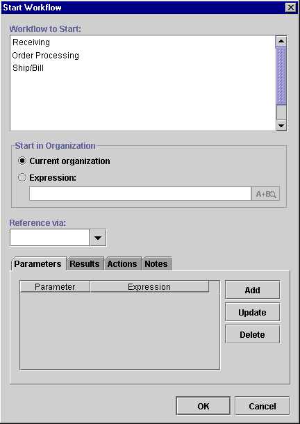

Start Workflow
This action supports subworkflows; variable values can be transferred from a parent workflow to a child workflow. You trigger a subworkflow (or child workflow) from a parent workflow. The started workflow can be tracked with a variable reference, and when it completes, you can perform an optional set of subactions.
Figure 5-18 Start Workflow Dialog Box
View or enter information in the Start Workflow dialog box.
Use the following tabs to select additional information for the action:

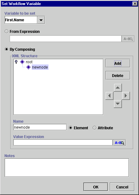

Set Workflow Variable
This action allows you to assign a value to a workflow variable, which can be an expression evaluated at run time or a literal. This action evaluates the expression or literal and assigns the result to a workflow variable when the action is executed.
In addition, this action allows you to compose an XML document and store the content in an XML type variable. XML type variables can be sent as internal or external XML messages using the action Post XML Event. For more information on this action, refer to Using XML Actions in Understanding WebLogic Process Integrator Events and XML Documents.
Figure 5-19 Set Variable Dialog Box
The Set Workflow Variable dialog box contains the following:
Note: An XML document that is stored in a string variable will first be converted to a string.

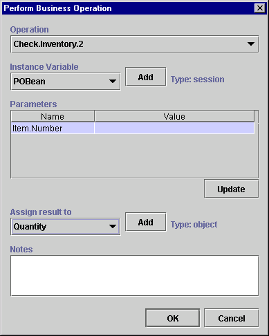

Perform Business Operation
Allows the invocation of a predefined business operation on an Enterprise JavaBean (EJB) or Java class. The results of such an invocation can be assigned to workflow variables. The Perform Business Operation action is linked to a WebLogic Process Integrator function called Business Operations (accessed through the Configuration menu). See Understanding Business Operations in Administering Data within WebLogic Process Integrator, for more information.
Figure 5-22 Perform Business Operation Dialog Box
View or enter information in the Perform Business Operation dialog box.

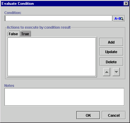

Evaluate Condition
Evaluate a conditional expression at run time and perform alternative sequences of subactions depending on the result. If the condition evaluates to True, one sequence of actions is performed, and if it is False, a different sequence of actions is performed instead. For example, a manager may be authorized to make purchases with a total value that is less than a specified amount, requiring higher approval if the amount exceeds this threshold. When a manager starts a purchase requisition workflow, the workflow can use an Evaluate Condition action to check whether this threshold would be exceeded, and to assign the task of approving the requisition either to the authorized person or to the manager.
Figure 5-26 Evaluate Condition Dialog Box
View or enter information in the Evaluate Condition dialog box.

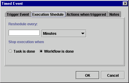

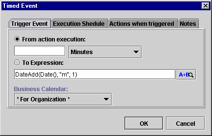

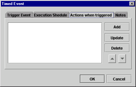

Timed Event
Create a timed even that will be triggered at an exact time and date according to a specified execution schedule.
Figure 5-27 Timed Event: Trigger Event Tab
View or enter information in the Trigger Event tab.
The Execution Schedule tab of the Timed Event dialog box allows you to specify that the event will be repeated according to a specified unit of time until the task is marked done or the workflow template definition is done.
Figure 5-28 Timed Event: Execution Schedule Tab
View or enter information in the Execution Schedule tab.
View or enter information in the Actions when triggered tab.

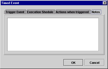

Use the Notes tab of the Timed Event dialog box to make notes about the action.

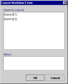

Cancel Workflow Event
This action cancels an event that has been defined within a workflow.
Figure 5-31 Cancel Workflow Event Dialog Box
View or enter information in the Cancel Workflow Event dialog box.
