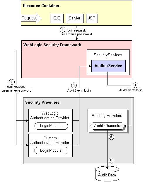

Figure 9-1 shows how Auditing providers interact with the WebLogic Security Framework and other types of security providers (using Authentication providers as an example). An explanation follows.
Figure 9-1 Auditing Providers, the WebLogic Security Framework, and Other Security Providers
Auditing providers interact with the WebLogic Security Framework and other types of security providers in the following manner:
Note: In Figure 9-1 and the explanation below, the "other types of security providers" are a WebLogic Authentication provider and a custom Authentication provider. However, these can be any type of security provider that is developed as described in Auditing Events From Custom Security Providers.
Note: An AuditEvent class is created by implementing either the AuditEvent SSPI or an AuditEvent convenience interface in the Authentication provider's runtime class, in addition to the other security service provider interfaces (SSPIs) the custom Authentication provider must already implement. For more information about Audit Events and the AuditEvent SSPI/convenience interfaces, see Create an Audit Event.
Note: This is a trusted call because the Auditor Service is already passed to the security provider's initialize method as part of its "Provider" SSPI implementation. For more information, see Understand the Purpose of the "Provider" SSPIs.
Note: For more information about audit severity levels and the Audit Context, see Audit Severity and Audit Context, respectively.
An Audit Channel is the component of an Auditing provider that determines whether a security event should be audited, and performs the actual recording of audit information based on Quality of Service (QoS) policies.
Note: For more information about Audit Channels, see Implement the AuditChannel SSPI.
