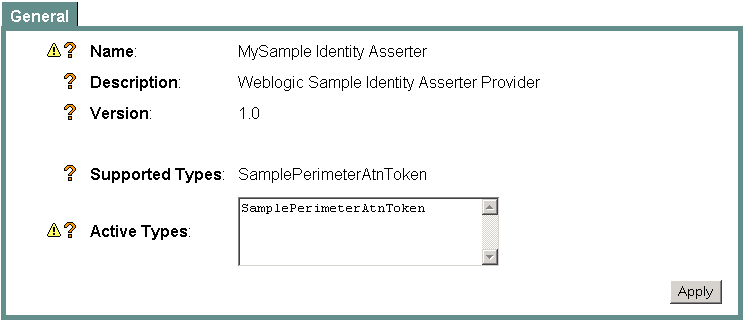

How to Make New Token Types Available for Identity Assertion Provider Configurations
When you or an administrator configure a custom Identity Assertion provider (see Configure the Custom Identity Assertion Provider Using the Administration Console), the Supported Types field displays a list of the token types that the Identity Assertion provider supports. You enter one of the supported types in the Active Types field, as shown in Figure 4-1.
Figure 4-1 Configuring the Sample Identity Assertion Provider
The content for the Supported Types field is obtained from the SupportedTypes attribute of the MBean Definition File (MDF), which you use to generate your custom Identity Assertion provider's MBean type. An example from the sample Identity Assertion provider is shown in Listing 4-2. (For more information about MDFs and MBean types, see Generate an MBean Type Using the WebLogic MBeanMaker.)
Listing 4-2 SampleIdentityAsserter MDF: SupportedTypes Attribute

Similarly, the content for the Active Types field is obtained from the ActiveTypes attribute of the MBean Definition File (MDF). You or an administrator can default the ActiveTypes attribute in the MDF so that it does not have to be set manually with the WebLogic Server Administration Console. An example from the sample Identity Assertion provider is shown in Listing 4-3.
Listing 4-3 SampleIdentityAsserter MDF: ActiveTypes Attribute with Default
<MBeanAttribute
Name= "ActiveTypes"
Type= "java.lang.String[]"
Default = "new String[] { "SamplePerimeterAtnToken" }"
While defaulting the ActiveTypes attribute is convenient, you should only do this if no other Identity Assertion provider will ever validate that token type. Otherwise, it would be easy to configure an invalid security realm (where more than one Identity Assertion provider attempts to validate the same token type). Best practice dictates that all MDFs for Identity Assertion providers turn off the token type by default; then an administrator can manually make the token type active by configuring the Identity Assertion provider that validates it.

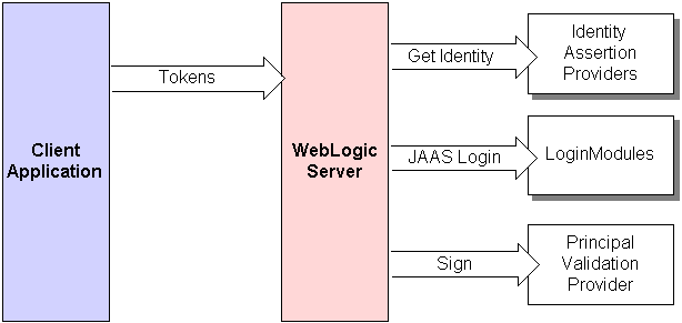

The Identity Assertion Process
In perimeter authentication, a system outside of WebLogic Server establishes trust via tokens (as opposed to the type of authentication described in The Authentication Process, where WebLogic Server establishes trust via usernames and passwords). Identity Assertion providers are used as part of perimeter authentication process, which works as follows (see Figure 4-2):
Figure 4-2 Perimeter Authentication
As Figure 4-2 also shows, perimeter authentication requires the same components as the authentication process described in The Authentication Process, but also adds an Identity Assertion provider.
Configuring a custom Identity Assertion provider means that you are adding the custom Identity Assertion provider to your security realm, where it can be accessed by applications requiring identity assertion services.
Configuring custom security providers is an administrative task, but it is a task that may also be performed by developers of custom security providers.
Note: The steps for configuring a custom Identity Assertion provider using the WebLogic Server Administration Console are described under "Configuring a Custom Security Provider" in Managing WebLogic Security.
