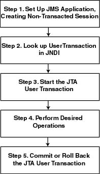

The following figure illustrates the steps required to set up and use a JTA user transaction.
Figure 5-2 Setting Up and Using a JTA User Transaction
Step 1: Set Up JMS Application, Creating Non-Transacted Session
Set up the JMS application as described in Setting Up a JMS Application, however, when creating sessions, as described in Step 3: Create a Session Using the Connection, specify that the session is to be non-transacted by setting the transacted boolean value to false.
For example, the following methods illustrate how to create a non-transacted session for the PTP and Pub/sub messaging models, respectively.
qsession = qcon.createQueueSession(
false,
Session.AUTO_ACKNOWLEDGE
tsession = tcon.createTopicSession(
false,
Note: When a user transaction is active, the acknowledge mode is ignored.
Step 2: Look Up User Transaction in JNDI
The application uses JNDI to return an object reference to the UserTransaction object for the WebLogic Server domain.
You can look up the UserTransaction object by establishing a JNDI context (context) and executing the following code, for example:
UserTransaction xact = ctx.lookup("javax.transaction.UserTransaction");
Step 3: Start the JTA User Transaction
Start the JTA user transaction using the UserTransaction.begin() method. For example:
xact.begin();
Step 4: Perform Desired Operations
Perform the desired operations associated with the current transaction.
Step 5: Commit or Roll Back the JTA User Transaction
Once you have performed the desired operations, execute one of the following methods to commit or roll back the JTA user transaction.
To commit the transaction, execute the following method:
xact.commit();
The commit() method causes WebLogic Server to call the Transaction Manager to complete the transaction, and commit all operations performed during the current transaction. The Transaction Manager is responsible for coordinating with the resource managers to update any databases.
To roll back the transaction, execute the following method:
xact.rollback();
The rollback() method causes WebLogic Server to call the Transaction Manager to cancel the transaction, and roll back all operations performed during the current transactions.
Once you call the commit() or rollback() method, you can optionally start another transaction by calling xact.begin().
