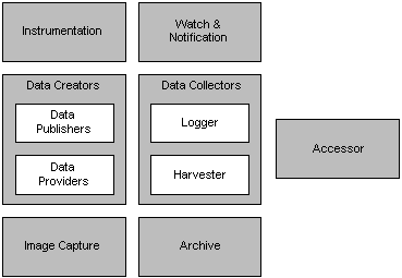

WLDF consists of the following:
Data creators generate diagnostic data that is consumed by the Logger and the Harvester. Those components coordinate with the Archive to persist the data, and they coordinate with the Watch and Notification subsystem to provide automated monitoring. The Accessor interacts with the Logger and the Harvester to expose current diagnostic data and with the Archive to present historical data. The Image Capture facility provides the means for capturing a diagnostic snapshot of key server state. The relationship among these components is shown in Figure 2-1.
All of the framework components operate at the server level and are only aware of server scope. All the components exist entirely within the server process and participate in the standard server lifecycle. All artifacts of the framework are configured and stored on a per server basis.

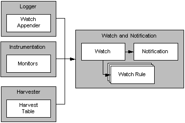

The Watch and Notification system can be used to create automated monitors that observe specific diagnostic state and send notifications based on configured rules.
A watch rule can monitor log data, event data from the Instrumentation component, or metric data from a data provider that is harvested by the Harvester. The Watch Manager is capable of managing watches that are composed of a number of watch rules. These relationships are shown in Figure 2-4.
One or more notifications can be configured for use by a watch. By default, every watch logs an event in the server log. In addition SMTP, SNMP, JMX, and JMS notifications are supported.

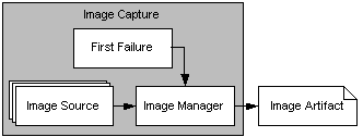

The Diagnostic Image support gathers the most common sources of key server state used in diagnosing problems and packages that state into a single artifact that can be made available to support, as shown in Figure 2-6. The diagnostic image is, in essence a diagnostic snapshot or dump from the server, analogous to a UNIX “core” dump.
The image capture support includes both an on-demand capture process and an automated capture based on some basic failure detection.

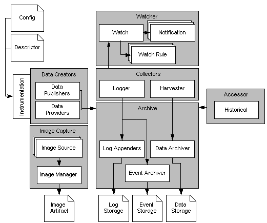

Figure 2-7 shows how all the parts of WLDF fit together.
