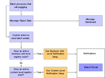

If the notification framework has been defined for the Message Dashboard, then a notification is sent to the owner of the peg when putaway is complete.

If the notification framework has been defined for the Message Dashboard, then a notification is sent to the owner of the peg when the stock completes putaway in the Inventory business unit.

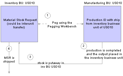

This process flow diagram illustrates pegging an MSR to a production ID in PeopleSoft Manufacturing:
Pegging an MSR to a production ID
The sequence of events in the process flow when pegging an MSR to a production ID is:
Peg is created using the Pegging Workbench. A material stock request (demand) can be pegged to a production ID when the Manufacturing business unit is the same as the Ship From Inventory business unit. You can only peg to the primary output of a production ID.
The production is completed and the output placed in the inventory business unit.
During putaway, the stock is soft-reserved or optionally allocated to the outgoing material stock requests based on your setting in the pegging setup pages. Once the production order is closed the peg status is changed to complete on both the demand and supply transactions.
The material stock request (demand-side) is fulfilled and shipped to the customer, department, or another inventory business unit.

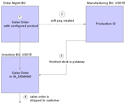

This process flow diagram illustrates pegging a sales order to a production ID:
Pegging a sales order to a production ID
The sequence of events in the process flow to soft peg a sales order to a production ID is:
Peg a sales order to an existing production ID using the Alternate Sources of Supply page in PeopleSoft Order Management. The CSR selects an existing production order as a supply source. This creates a soft peg. When the sales order is saved it is inserted into the IN_DEMAND table in PeopleSoft Inventory. The Manufacturing business unit of the production ID must be the same as the Ship From Inventory business unit on the sales order. You can only peg to the primary output of a production ID.

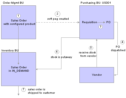

This process flow diagram illustrates pegging a sales order with a configured product to a requisition in PeopleSoft Purchasing:
Pegging a sales order with a configured product to a requisition
The sequence of events in the process flow for a configured product sourced from PeopleSoft Purchasing is:
A sales order with a configured product is created and saved. The demand line contains a configuration code generated by your PeopleSoft Product Configurator setup. This configuration code uniquely identifies the exact configuration for this product. The configured item is also lot-controlled. When the sales order is saved, it is inserted into the IN_DEMAND table in PeopleSoft Inventory.
The Requisition Loader process in PeopleSoft Purchasing, creates a requisition to fulfill the sales order. This requisition contains the configuration code. The Requisition Loader process also creates a soft peg between the sales order and the requisition. This soft peg is stored in IN_PEGGING and its related tables.
The requisition goes through the sourcing processes in PeopleSoft Purchasing and is sourced to a purchase order.
The purchase order is dispatched to the vendor.
The vendor ships the stock and it is received into the purchasing business unit. If the notification framework has been defined for the Message Dashboard, then a notification is sent to the owner of the peg when stock is received into the purchasing business unit.
The stock from the vendor is putaway in the inventory business unit. During putaway, the stock is lot-allocated to the outgoing sales order. Lot allocation reserves the incoming stock to the sales order at the business unit, item, lot, and storage location levels. In the IN_PEGGING table, if the pegged quantity (QTY_PEGGED field) is equal to the putaway pegged quantity (QTY_COMPLETE field) then the peg status in this table is updated to complete. If either the demand or supply order has no more open peg quantity, then the peg status on the order itself is also updated to complete.
If the notification framework has been defined for the Message Dashboard, then a notification is sent to the owner of the peg when the stock completes putaway in the inventory business unit.
The sales order is fulfilled and shipped to the customer.
This process flow diagram illustrates pegging a sales order with a configured product to a production ID in PeopleSoft Manufacturing when the ship from inventory business unit is the same on the sales order and the production ID. In other words, the stock is shipped to the customer from the manufacturing finished goods warehouse.
Pegging sales order with a configured product to production ID when ship from unit is the same
The sequence of events in the process flow for a sales order with a configured product to a production ID when the ship from inventory business unit is the same on both transactions is:
The Production Request process in PeopleSoft Product Configurator, creates a production ID to fulfill the sales order. This production ID in PeopleSoft Manufacturing contains the configuration code. The Production Request process also creates a soft peg between the sales order and the production ID. This soft peg is stored in IN_PEGGING and its related tables.
The production is completed and the output placed in the inventory business unit. During putaway, the stock is lot-allocated to the outgoing sales order. Lot allocation reserves the incoming stock to the sales order at the business-unit, item, lot, and storage location levels. The peg status is changed to complete in the IN_PEGGING record and in the supply and demand transactions if either:
The production order is closed.
All the pegged quantity has been received and putaway (QTY_COMPLETE=QTY_PEGGED).

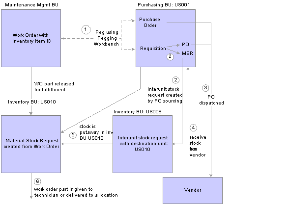

This process flow diagram illustrates pegging a work order with an inventory item ID to a requisition or purchase order:
Pegging a work order with an inventory item ID to a requisition or purchase order
The sequence of events in the process flow when pegging a work order with an inventory item ID to a requisition or purchase order is:
Peg is created using the Pegging Workbench. When a work order part is pegged, it is placed in the IN_DEMAND table for fulfillment, if it is not already there. A work order is pegged to a requisition or purchase order.
The requisition goes through the PO sourcing module and is sourced to an interunit stock request or a purchase order or both. The interunit stock request is created in the sending inventory business unit.
The vendor ships the stock and it is received into the Purchasing business unit. If the notification framework has been defined for the Message Dashboard, then a notification is sent to the owner of the peg when stock is received into the Purchasing business unit.
The stock from the vendor or the sending inventory business unit is putaway in the destination inventory business unit. During putaway, the stock can be soft-reserved or allocated. In the IN_PEGGING table, if the pegged quantity (QTY_PEGGED field) is equal to the putaway pegged quantity (QTY_COMPLETE field) then the peg status in this table is updated to complete. If either the demand or supply order has no more open peg quantity, then the peg status on the order itself is also updated to complete.
The work order part is fulfilled in PeopleSoft Inventory using the picking or issue features for work orders in the Fulfill Work Orders menu. The work order part is given to a technician or delivered to a location.

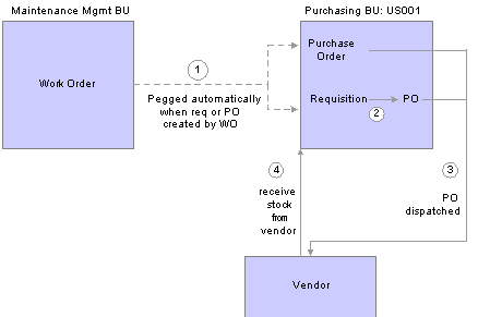

Pegging a Work Order with a Non-Inventory ItemWhen using a non-inventory item ID or a description-only item on a work order line, you cannot peg to a materials stock request (interunit transfer, supply-side) or a production ID. You can peg to a requisition or purchase order. You can create the peg from the PeopleSoft Maintenance Management side or the PeopleSoft Purchasing side. The Pegging Workbench cannot be used to peg a non-inventory item ID or a description-only item. The Pegging Inquiry component can be used to view peg chains to non-inventory item ID or a description-only items.
This process flow diagram illustrates pegging, from PeopleSoft Maintenance Management, a work order that is using a non-inventory item ID or a description-only item:
Pegging a work order with non-inventory items to a requisition or purchase order
The sequence of events in the process flow is:
Using the Work Order - Schedules page, select the Purchase/On-Hand link, add a non-inventory item or description-only item, and then:
Click the Load Requisition button to place the work order line in a staging table where the Requisition Loader process will retrieve it and create a requisition in PeopleSoft Purchasing.
Click the Load Purchase Order button to place the work order line in a staging table where the Create Purchase Order process will retrieve it and create a purchase order in PeopleSoft Purchasing.
Use the sourcing module in PeopleSoft Purchasing to build a purchase order from the requisition. The requisition cannot be placed on a material stock request since there is no inventory item ID.
If receiving is required, then the parts are received into the purchasing business unit. If receiving is not required, then the peg status is updated to complete when the purchase order is closed.
This process flow diagram illustrates pegging, from PeopleSoft Purchasing, a work order that using a non-inventory item ID or a description-only item:
Pegging from PeopleSoft Purchasing with a non-inventory item to a work order
The sequence of events in the process flow when pegging from PeopleSoft Purchasing to a work order is:
Create a requisition or purchase order line:
In the Add/Update Requisitions component in PeopleSoft Purchasing, add a non-inventory item ID or a description-only item, select the Schedule button, select the Maintenance WO tab. Enter the Maintenance WO business unit, work order, task number, resource type, and resource line number. The work order ID and task must already exist in PeopleSoft Maintenance Management, however the resource line number can be added here if needed. If the item does not exist on the work order and you want to add it, then leave the resource line number at zero. When the requisition is saved, a peg is automatically created between the requisition line and the work order.
In the Add/Update Purchase Order component in PeopleSoft Purchasing, add a non-inventory item ID or a description-only item, select the Schedule button, select the Maintenance WO tab. Enter the Maintenance WO business unit, work order, task number, resource type, and resource line number. The work order ID and task must already exist in PeopleSoft Maintenance Management, however the resource line number can be added here if needed. If the item does not exist on the work order and you want to add it, then leave the resource line number at zero. When the purchase order is saved, a peg is automatically created between the purchase order line and the work order.
For a requisition, use the sourcing module in PeopleSoft Purchasing to source the requisition into a purchase order. The requisition cannot be placed on a material stock request since there is no inventory item ID.

Pegging in PeopleSoft ManufacturingA production ID from PeopleSoft Manufacturing can be pegged as supply to stock requests and transfer demand in PeopleSoft Inventory and to sales orders in PeopleSoft Order Management. The following rules apply when pegging production:
You can peg to a production ID but not a production schedule.
You can only peg to the primary output of a production ID, not co-products or by-products.
Once a production ID has been pegged, you cannot split it.
You can access peg chains and create new peg chains by accessing the Pegging Workbench or view peg chains by accessing the Pegging Inquiry page from the Maintain PIDs - Production ID Outputs page in PeopleSoft Manufacturing. In addition, you can access the Pegging Inquiry page from:
Record Completions and Scrap component
The PID/Schedule inquiry component
The Review Dispatch List inquiry component
Note. The link to the Pegging Workbench is only visible if the User Security page gives access to the user ID.
Pegging chains are also visible on the Production report, Print Production documents and Dispatch List report.
To view process flow diagrams about pegging production IDs, see the demand-side sections in this chapter about pegging to PeopleSoft Inventory and PeopleSoft Order Management.

Pegging Notification Process Flow
The following diagram illustrates the process flow for notifications from online pegging processes:
Notifications from online pegging processes
The following diagram illustrates the process flow for notifications from batch pegging processes:
Notifications from batch pegging processes
