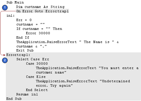

Using a Label to Handle Custom Errors
Figure 5 includes an example that uses a label to handle a custom error.
Figure 5. Example That Handles Custom Errors With a Label
Explanation of Callouts
The example that uses a label to handle a custom error includes the following items:
  1. Place the code that handles the error immediately before the line of code that could cause an error.
  2. Use a labeled section of code to handle the custom error.
