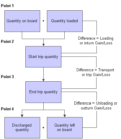

You can also calculate any gains or losses that might have occurred during transportation, such as losses due to spillage, theft, and faulty meters. To do so, you perform a four-point analysis. Four-point refers to the opening and closing readings at a supplying location, and the opening and closing readings at a receiving location. Analysis refers to the variance between the two results (that is, the gain or loss). You perform a four-point analysis primarily to determine the quantity of stock lost in transit during a lengthy voyage, but you can record the data for any movement.
If you take ownership of the product when it is loaded onto a vehicle at a supplier's depot, you can track the quantity loaded onto the vehicle and record it as a liability. Then you can calculate and record any gain or loss that might have occurred at the time of delivery at the depot.

Click to jump to parent topicCalculating Gain or Loss for Received Products
This section provides an overview of gain and loss calculations for received products and discusses how to calculate gain or loss for received products.
Click to jump to top of pageClick to jump to parent topicUnderstanding Gain and Loss Calculations for Received Products
Use four-point analysis when you record received products to calculate any gains or losses that might have occurred during shipment. Four-point refers to the opening and closing readings at a supplying location, and the opening and closing readings at a receiving location. Analysis refers to the variance between the two results (that is, the gain or loss).
You can choose to perform a four-point analysis for each line item on a purchase order. You can also perform a four-point analysis on partial receipts. The program creates a four-point record for each receipt.
The data from a four-point analysis is informational only. It does not update the gain/loss table or the general ledger, and you cannot retrieve this data for other programs. If you need the output elsewhere, for example, to enter a gain or loss manually, print the form and enter the data in the required program.
If you receive an item that is set up for receipt routing, you can set a processing option in receipts entry to call the Four-Point Analysis program when product is routed to the payment eligible and on-hand steps.
This diagram illustrates a four-point analysis:
Four-point analysis
During four-point analysis, the system:
Recording Standard Quantities
You can enter standard quantities if you already have them. If you enter standard quantities, you do not need to access the Four-Point Temperature/Density form to convert ambient quantities to standard quantities.
Volume Calculations for Four-Point Analysis
You can use Dip Volume Calculator to enter the opening and closing dip readings of any supplying or receiving point, and calculate volumes. You can then print the dip calculations, return to the Four-Point Analysis form, and enter the quantities in the appropriate fields.
Receipt Reversal
If you reverse a receipt entry for a bulk product, the system calls the Four-Point Analysis program and reverses the four-point analysis record.
