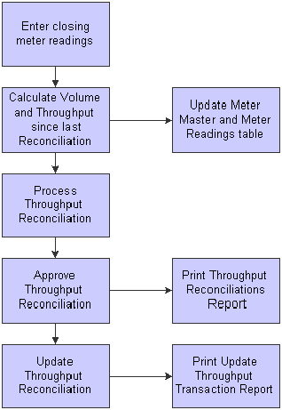

Click to jump to top of pageClick to jump to parent topicUnderstanding Throughput Reconciliations
Throughput reconciliation compares sales figures and other metered outgoing transactions for a given period with the metered throughput at the point of reconciliation. The comparison identifies discrepancies due to missing transactions, theft, leakage, or faulty meters.
Throughput reconciliation is optional. However, if you perform throughput reconciliation through the time period in which you begin operational reconciliation, the operational reconciliation process will be more accurate.
Throughput reconciliation compares the transactions in the system with the throughput meter readings. Throughput reconciliation does not update inventory and general ledger tables. Upon review and approval, the program updates the reconciliation status in the Bulk Product Transaction File table (F41511) and the Gain/Loss Transactions File table (F41512) .
This flowchart illustrates the throughput reconciliation process:
Throughput reconciliation process

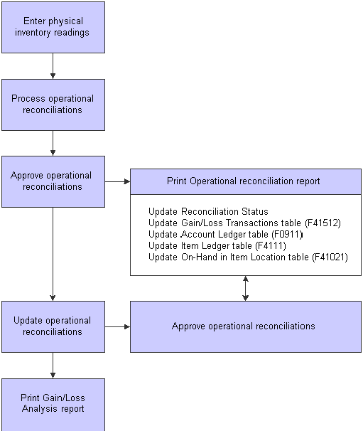

Click to jump to top of pageClick to jump to parent topicUnderstanding Operational Reconciliations
Operational reconciliation updates inventory and general ledger tables. Using all inbound and outbound transactions since the previous reconciliation, the system calculates the amount that should be in physical inventory and compares it with the actual amount in the tanks (from the final physical tank dip). In other words, it measures and compares the physical inventory levels with the book inventory levels so that you can reconcile any differences and record operational gains or losses. The system then updates inventory tables to reflect the current physical stock levels. Although most companies perform operational reconciliations daily, some companies perform them monthly.
During operational reconciliation, the system can include the throughput gains and losses with the operational gains and losses and update the general ledger.
Operational reconciliation updates these tables:
This flowchart illustrates operational reconciliation:

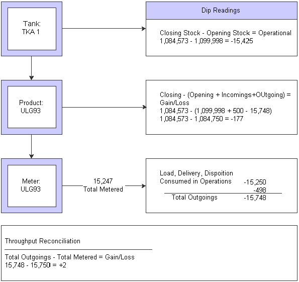

Example: Calculating Reconciliations
This diagram illustrates how the system calculates reconciliations for bulk products. The quantities (in liters) are shown to help you understand the process:
Example of calculating reconciliation for bulk stock

Click to jump to parent topicUpdating Operational Reconciliations
This section provides an overview of operational reconciliation update and discusses how to:
Click to jump to top of pageClick to jump to parent topicUnderstanding Operational Reconciliation Update
Run the Update Operational Reconciliations report to update:
The program does not enable retroactive adjustments. It rejects any record with a general ledger date that precedes the current accounting period.
You can run this program in proof mode before you complete the actual update. Proof mode enables you to review each transaction and verify the information before you update the tables. To run in proof mode, add a proof version and leave the Update Records processing option blank.
Failure of operational reconciliations might be due to:
Click to jump to top of pageClick to jump to parent topicSetting Processing Options for Update Operational Reconciliations Report (R415021)
Processing options enable you to specify the default processing for programs and reports.
Date/Time
As of Date
Specify the date the transaction was operationally reconciled. The Update Operational Reconciliations process updates this processing option.
As of Time
Specify the time through which to reconcile all transactions.
Status
Enter the current reconciliation status and Enter the next reconciliation status
Specify the current status or next status in the reconciliation process. Entries in the Enter the current reconciliation status field are UDCs.
Note. Set up Reconciliation Status - Current UDCs sequentially in the same order as the process flow. The same codes are used for Reconciliation Status - Next.
Update - Y/N
Update Records
Specify whether you want the system to update records. Values are:
Blank: Do not update records (default value).
1: Update records.
Document Type
Document Type
Specify the document type to be used for creating the adjusting entry.
A UDC from 00/DT that identifies the origin and purpose of the transaction.
G/L Information
1. Date for Processing Update and 2. Date for Processing Retroactive Gain/Loss
Specify the General Ledger date for processing the update or the retroactive gain/loss. If left blank, the system provides the current system date by default.
3. Summary or Detail Mode
Specify whether the report runs in summary or detail mode. Values are:
Blank: Run the report in detail mode, and the general ledger accounts will be produced for each detail line.
1: Run the report in summary mode, and the general ledger accounts will be summarized within each document number.
4. Version
Enter the Processing Option version to use for the G/L Functional Server XT0911Z1. If you leave this processing option blank, the default version ZJDE0001 is used.
UDC Information
Document Types
Enter the UDC containing the document types for:
Incomings: system code
Incomings: record type
Outgoings: system code
Outgoings: record type
Click to jump to top of pageClick to jump to parent topicUpdating Operational Reconciliations
From the Bulk Stock Reconciliations menu (G41502), select Update Oper Reconciliations.
