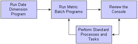

Transactional data is the basis of the JD Edwards EnterpriseOne Console metrics. The system summarizes and transforms data, as needed, into the metric aggregation tables for better performance and uniformity. The JD Edwards EnterpriseOne Console uses multiple batch programs to load and create the data information about the metrics. You must run the batch programs sequentially for the data to be complete and accurate. This diagram illustrates the JD Edwards EnterpriseOne Console business process flow for data:
JD Edwards EnterpriseOne Consoles process
The console enables you to evaluate the data about metrics using charts and grids. As you complete standard business tasks and processes, you should run the batch programs to keep this data current and accurate. The system must populate tables within the JD Edwards EnterpriseOne Console with data before you can run subsequent batch programs.
When you run the batch programs, consider these guidelines:
The batch programs within each group do not depend on one another.
The programs within the first group can be run at any time after the Date Dimension program. You do not have to run the programs sequentially or in numerical order.
Most of the batch programs should be run daily. Some should be run weekly.
The Date Dimension program must be run before you load any data for the JD Edwards EnterpriseOne Console, and should be run only as required.
Not all batch programs perform the actual metric calculation. The system also performs calculations during runtime of the console. The system stores data at the lowest level of aggregation and performs the calculations at runtime to maximize performance.
See Loading Data.
