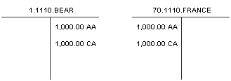

The system identifies this journal entry as an intercompany transaction between two companies that have different base currencies and uses an exchange rate of 1. When the exchange rate is 1, the system also creates an entry for the transactions in the foreign currency (CA) ledger.
In the CA ledger, the value for company 70 (the French company) is the foreign amount (USD) of the transaction. The value for company 1 keeps the CA ledger in balance.
The system creates entries in the CA ledger as follows:
Account
Amount
Ledger Type
1.1110.BEAR
–1,000.00
CA
70.1110.FRANCE
1,000.00
CA

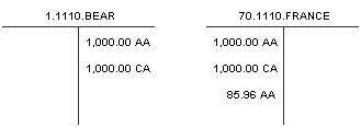

Adjusting Entry and the Post
When you post the journal entry, the system creates an adjusting entry of 85.96 EUR to correct the AA amount of the non-base currency. The line extension code for the adjusting entry is AM. This AM record appears only on the General Ledger Post Report and in the Universal Table Browser (UTB) for F0911.
Account
Amount
Ledger Type
1.1110.BEAR
– 1,000.00 USD
AA
70.1110.FRANCE
1,000.00 EUR
AA
70.1110.FRANCE
85.96 EUR
AA
1.1110.BEAR
– 1,000.00 USD
CA
70.1110.FRANCE
1,000.00 USD
CA
The 85.96 EUR adjusting entry is the net amount of this calculation:
(Foreign value of the transaction × exchange rate) − value of transaction already posted
(1,000.00 × 1.08596) − 1,000.00 = 85.96 EUR
The total EUR amount is 1,085.96 (1,000.00 × 1.08596).

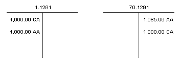

Intercompany Settlement and the Post
The system creates the final journal entries that complete the intercompany settlement and keep companies 1 and 70 in balance as shown in this table:
Account
Amount
Ledger Type
1.1291
1,000.00 USD
AA
70.1291
–1,085.96 EUR
AA
1.1291
1,000.00 EUR
CA
70.1291
–1,000.00 USD
CA
T-Accounts for Multicurrency Intercompany Settlements
The system creates a journal entry to credit the cash account for company 1 and debit the cash account for company 70. It records these entries in U.S. dollars (USD), as entered, in both the actual amount (AA) and foreign currency (CA) ledgers as shown:
T-account for multicurrency intercompany journal entries
When you post the journal entry, the system creates an adjusting entry in the AA ledger to convert the USD amount to EUR for company 70. The exchange rate is 1 USD = 1.08596 EUR. The system has already debited 1,000.00 from company 70, so it debits an additional 85.96, as shown:
T-account for multicurrency intercompany adjusting entries
When you post the journal entry, the system creates additional automatic entries to transfer the money between the companies, as shown (the intercompany accounts receivable account is 1291):
T-account for multicurrency intercompany automatic entries
