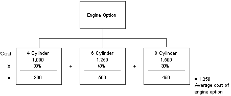

Understanding Product Costing for Kit ItemsWhen you use kit items with options, the Cost Simulation program (R30812) calculates the average cost of the kit parent item, based on the feature cost percentage. The system can calculate the average cost for a kit parent item if:
The kit parent item has a stocking type of M (manufactured).
You have entered the feature cost percentage of the components on the bill of material.
The Cost Simulation program multiplies the feature cost percentage with the cost of the option from the Item Cost table (F4105) to determine the option's share of the average cost of the kit parent item. The program then adds monetary amounts for each option to determine the average cost for the kit parent item.
This diagram illustrates product costing for a kit item.
Product costing for a kit item

Reviewing Product Costing for a Percent Bill of MaterialThis section provides an overview of product costing for a percent bill of material and discusses how to review product costing for a percent bill of material.
Understanding Product Costing for a Percent Bill of MaterialIn either process or discrete manufacturing environments, you use a percent bill of material to express the parts or ingredients as a percentage of the parent quantity.
If you use percent bills of material, the system calculates costs based on the quantities that are specified in the percent bill. Quantities are expressed in percentages (such as 75 for 75 percent), and the total of the component quantities must equal 100. Components must have a unit of measure that can convert to the parent unit of measure without causing rounding errors. For bills of material with a zero batch quantity, the cost rollup calculates the cost for one primary unit of measure for the parent product.
Note. You must have a multidecimal environment to use percent bills.
