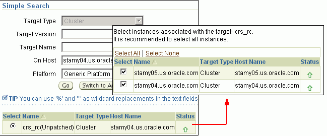

On the Target List page, in the Clusterware Targets to be Patched section, click Add to add the clusterware targets you want to patch. Then click Next.
When you click Add, Enterprise Manager Grid Control displays the Select Target page. On this page, search and select the clusterware you want to patch, and click Continue. On the next page, select the associated instances, and click Select to return to the Target List page.

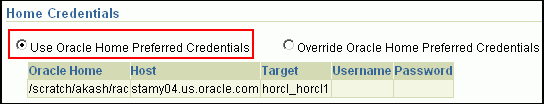

On the Credentials page, in the Home Credentials section, specify the Oracle home credentials required to patch the clusterware Oracle homes, and in the Host Credentials section, specify the operating system credentials to log in to the hosts where the clusterware Oracle homes are present. Then click Next.
Note: When there are Oracle home active steps, the Home Credentials section appears. When there are host-level active steps, the Host Credentials section appears. When Oracle home active steps and host-level active steps are present, both the sections appear. |
For both sections, choose to use the preferred credentials so that the credentials stored in the Management Repository can be used.
Of course, you can always override the preferred credentials with a new set of credentials. If you choose to do so, you can specify either a common set of credentials to be used across Oracle homes and hosts, or a unique set of credentials for each Oracle home and host.
After specifying a new set of credentials to override the preferred credentials, click Save OH Credential if you want to store the new credentials in the Management Repository.
On the Credentials page, in the Home Credentials section, specify the Oracle home credentials required to patch the Oracle homes, and in the Host Credentials section, specify the operating system credentials to log in to the hosts where the Oracle homes are present. Then click Next.
