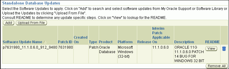

In the Standalone Database Updates section, click Add to search and select software updates from either My Oracle Support or the Software Library. Alternatively, if you have a text file that contains details about the patches, then click Upload From File to select and upload that text file.
On clicking Add, Enterprise Manager Grid Control displays the Search and Select Software Updates page. On this page, if you are running the prerequisite checker Deployment Procedure in online mode, then select Search My Oracle Support. If you are running it in offline mode, then select Search Software Library. Specify the details of the patches you want to search, and click Go.
In online mode, Enterprise Manager Grid Control connects to My Oracle Support and searches the patches there. In offline mode, Enterprise Manager Grid Control searches the patches in the Software Library. Select the ones you want to apply using the Deployment Procedure, and click Select.
On clicking Upload From File, Enterprise Manager Grid Control displays the Upload File page. On this page, select Upload from Local Machine or Upload from Software Library depending on where the text file is available, click Browse to search and select that file, and then click Upload.

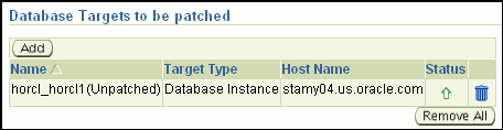

On the Target List page, in the Database Targets to be Patched section, click Add to add the database targets you want to patch. Then click Next.

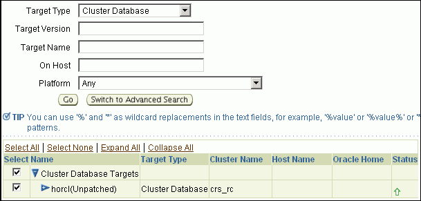

On the Target List page, in the RAC Database Targets to be Patched section, click Add to add the Oracle RAC database targets you want to patch. Then click Next.

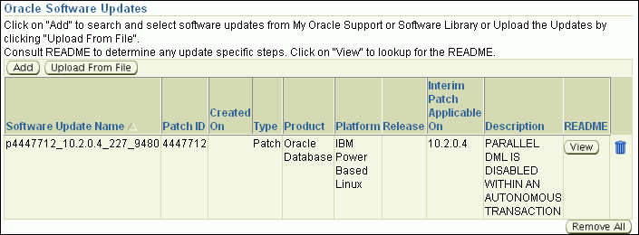

In the Oracle Software Updates section, click Add to search and select software updates from either My Oracle Support or the Software Library. Alternatively, if you have a text file that contains details about the patches, then click Upload From File to select and upload that text file.

On the Target List page, in the ASM Targets to Perform Prerequisite Checks section, click Add to add the ASM targets you want to patch. Then click Next
When you click Add, Enterprise Manager Grid Control displays the Select Target page. On this page, search and select the ASM target you want to patch, and click Select.
