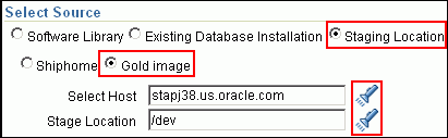

In the Select Source section, select Existing Database Installation. Then click the torch icon for Source Host and select the host on which the existing Oracle Database is running.
In the Source Host Details section, by default, Oracle Home, Working Directory, and Files to exclude are prefilled.
Oracle Home shows where the existing instance is installed, but this is a non-editable field. For Working Directory, specify the full path to a directory on source host where the files related to cloning can be staged temporarily. For Files to exclude, specify file names that must not be cloned to the source host. Use a comma to separate the file name, and use the wildcard (*) to indicate all files with the same extension. For example, *.trc. Note that any file or folder corresponding to the regular expressions provided here will be excluded from the clone archive that is created

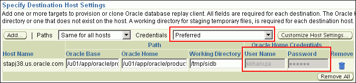

In the Source Host Credentials section, select Use Preferred Credentials to use the credentials stored in the Management Repository.
In the Specify Destination Host Settings section, click Add and select the target hosts on which you want to clone the existing instance of Oracle Database.
By default, Oracle Base, Oracle Home, and Working Directory are prefilled with sample values. Edit them and specify values that match with your environment and standards. If the directories you specify do not exist on the target hosts, then they will be created by the Deployment Procedure.
From the Credentials list, retain the default selection, that is, Preferred, so that the preferred credentials stored in the Management Repository can be used.
Note: You can optionally override these preferred credentials. The credentials you specify here are used by the Deployment Procedure to run the provisioning operation. If this environment is secure and has locked accounts, then make sure that:
For more information, see Chapter 23, "Customizing Steps to Run as Another User". |
If you have selected multiple hosts, then from the Path list, select Same for all hosts if you want to use the same path across hosts, or select Different for each host if you want to use different paths for each host.

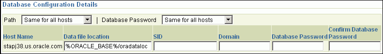

In the Database Configuration Details section, specify basic configuration details such as the data file location, SID, domain, and password.
You can choose to append %HOST_NAME% or %SHORT_HOST_NAME"% to the data file location so that the path is unique when shared location is used. Also ensure that the SID and domain are unique for each host.

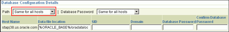

If you have selected multiple hosts, then from the Path list, select Same for all hosts if you want to use the same path to the dat file location across hosts, or select Different for each host if you want to use different paths for each host.

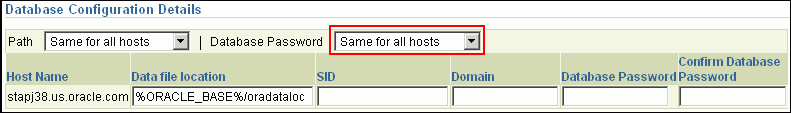

Also, from the Database Password list, select Same for all hosts if you want to use the same set of passwords, or select Different for each host if you want to use different passwords for each host.

In the Specify Destination Host Settings section, click Add and select the target hosts on which you want to install the gold image of Oracle Database.

In the Select Source section, select Staging Location, and then select Gold Image. Click the torch icon for Select Host and select the host on which the gold image is staged. Then click the torch icon for Stage Location and select the location where the gold image is staged.
If you have selected multiple hosts, then from the Path list, select Same for all hosts if you want to use the same path to the data file location across hosts, or select Different for each host if you want to use different paths for each host.

In the Select Source section, select Software Library. Then click the torch icon for Component and select the generic component that has the software binaries of Oracle Database. Ensure that you select only components that are in "Ready" status.
Note: If you do not see the required component in the Software Library, then follow the workaround described in Appendix A, "Troubleshooting Issues". |
In the Specify Destination Host Settings section, click Add and select the target hosts on which you want to install the standalone Oracle Database.

On the Database Configuration page, do the following:
You can choose to use %HOST_NAME% or %SHORT_HOST_NAME"% to the data file location so that the path is unique when a shared location is used. Also ensure that the SID and domain are unique for each host.
If you have selected multiple hosts, then from the Path list, select Same for all hosts if you want to use the same path to the data files across hosts, or select Different for each host if you want to use different paths for each host.
