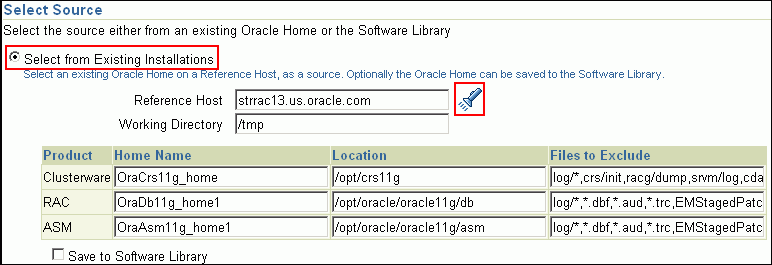

On the Select Source page, do the following:
In the Select Source section, select Select from Existing Installations. Then click the torch icon for Reference Host and select the host on which the existing Oracle RAC installation is running. Once you select the reference host, the application automatically displays the working directory and the details of the selected Oracle Clusterware and Oracle Database.
If you want to save the selected Oracle Clusterware and Oracle Database as gold images in the Software Library, then click Save to Software Library. Oracle Clusterware is saved as a Clusterware Clone component type and Oracle Database is stored as a Database Clone component type, respectively.

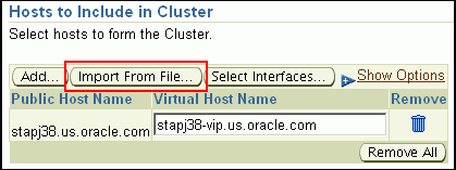

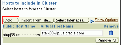

On the Select Hosts page, do the following:
In the Hosts to Include in Cluster section, click Add and select the target hosts that should form the cluster. To see more details about the selected hosts, click Show Options.
Note: When you click Add, the Select Target pop-up window appears. On this page, by default, the Show Suitable Hosts option is selected and the table lists only those hosts that are best suited for provisioning. If you do not find the host you want to add, then select Show All Hosts to view a complete list of hosts. |

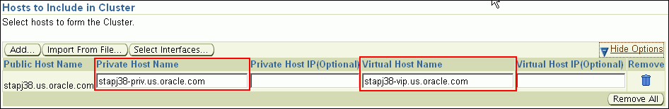

By default, Private Host Name and Virtual Host Name are automatically prefilled with values. Edit them and specify values that match with your environment. Optionally, you can also specify their IP addresses.
Note: If the prefilled, default values of Private Host Name and Virtual Host Name are incorrect, then see the workaround described in Appendix A, "Troubleshooting Issues". |
If you already have these details stored in cluster configuration file, then click Import From File to select that cluster configuration file. This file typically contains information about the new hosts to be added. To understand how a cluster configuration file looks, see the sample file shown in Sample Cluster Configuration File.

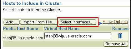

To configure the private and public network interfaces, click Select Interfaces. By default, the interfaces that have the same name and subnet for the selected target hosts are displayed. However, you can also choose to view all the interfaces for the selected target hosts. You can either select one of the existing interfaces or specify a completely new one if the interface you want to use does not exist.
In the Network Interface Configuration section, review the details of the private and public interfaces.

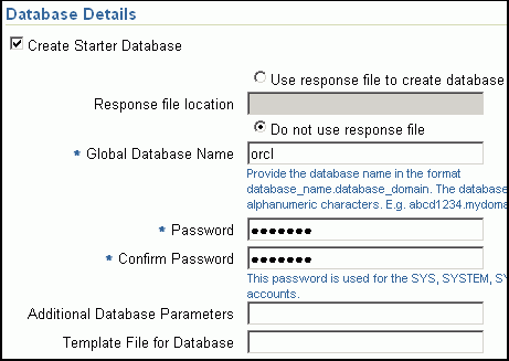

In the Database Details section, retain the default selection for creating a starter database.
Note: If the database creation steps are disabled in the Deployment Procedure, then you will not see this section. |
If you want to create a general-purpose database, then leave all the fields in this section blank. Otherwise, provide the required details as described in this step.
If you have a custom response file that already has the options enabled, then select Use response file to create database, and specify the full path to a location where the file is available. The file may be available on the target host, in a shared location accessible from the target host, in the Software Library, or in a location where an existing database is running.
Note: From the Software Library or from the location where an existing database is running, only a.dbt template file can be used. However, from the target host or a shared location, any template file can be used. |
If you do not have a custom response file, then select Do not use response file, and provide the global database name, the credentials, and the additional parameters you want to run while creating the starter database.
Note: Ensure that the database name you specify is in the format database_name.database_domain. It must have 1 to 8 alphanumeric characters. For example, orcl.mydomain.com. Also note that the credentials you provide are used for SYS, SYSTEM, SYSMAN, and DBSNMP accounts. |
If you want to use the structure of an existing database and have a custom template to structure the new database, then in Template File for Database, specify the full path to a location where the template file is available. The file may be available on the target host or on a shared location accessible from the target host.
Note: If you do not store the response files and templates in a central location, you can always customize the Deployment Procedure to add another step that copies the response file or template to the target host before invoking the configuration tools to create the database. |

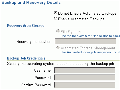

In the Backup and Recovery Details section, retain the default selection, that is, Do not Enable Automated Backups if you do not want to have backups taken.
Alternatively, if you want to enable automated backups, select Enable Automated Backups, specify the full path to a directory location from where the backed-up files can be recovered, and provide the operating system credentials for running the backup job. Note that recovery location is the same location as the backup location because this where the files are backed up and also recovered from.

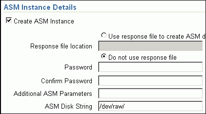

In the ASM Instance Details section (appears only if you had selected to deploy ASM), retain the default selection, that is, Create ASM Instance, and specify the credentials, additional ASM parameters to be used, and the ASM disk string to be used.
Important: If you are provisioning Oracle Database 10g and Oracle ASM 10g, then ensure that you specify the same password for database as well as ASM. |
If you have a custom response file that already has the options enabled, then select Use response file to create ASM database, and specify the full path to a location where the file is available. The file may be availableon the target host or on a shared location accessible fromt he target hosts.
If you do not want to use a response file, then select Do not use response file.

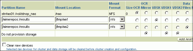

On the Storage page, do the following:
In the Shared Storage Configuration section, provide details about the storage devices and click Next. Specify the partition name and the mount location, and select the mount format and a storage device for storing data. While partition name is the path to the location where the device is installed, mount location is the mount point that represents the partition location.
While configuring the storage device, at a minimum, you must have a partition for at least OCR, Voting Disk, and data files. You cannot designate the same storage device to multiple partitions.
Oracle recommends designating the OCR and the OCR Mirror devices to different partitions. Similarly, Oracle recommends designating the Voting Disk, Voting Disk1, and Voting Disk2 to different partitions.
Before clicking Next, do the following:
- If you want to clear the data on selected raw devices before creating and configuring the cluster, then select Clear raw devices.
- If you have configured only for a few storage devices, then select Do not provision storage for others that you do not want to provision.
- Specify the ASM disk string to be used.
In the Options section, select the ASM redundancy mode. The default is None, which requires 7 GB of space. While Normal requires 16 GB of space, High requires 32 GB.

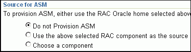

(Optional) In the Source for ASM section, do one of the following:
If you do not want to deploy ASM, then retain the default selection, that is, Do not Provision ASM.
If you want to deploy ASM in the same Oracle home as the Oracle RAC, then select Use the same source as the RAC home. Alternatively, if you can select Choose a component and upload an ASM component from the Software Library.
In the Select Source section, select Select from Software Library.
In the Source for Clusterware section, click the torch icon and select the generic component that has the software binaries of Oracle Clusterware. Ensure that you select only components that are in "Ready" status. Once you select the component name, the application automatically displays the component location.
Note: If you do not see the required component in the Software Library, then follow the workaround described in Appendix A, "Troubleshooting Issues". |
In the Source for RAC section, click the torch icon and select the generic component that has the software binaries of Oracle Database. Ensure that you select only components that are in "Ready" status. Once you select the component name, the application automatically displays the component location.
If you already have these details stored in a cluster configuration file, then click Import From File to select that cluster configuration file. This file typically contains information about the new hosts to be added. To understand how a cluster configuration file looks, see the sample file shown in Sample Cluster Configuration File.
If you have a custom response file that already has the options enabled, then select Use response file to create ASM database, and specify the full path to a location where the file is available. The file may be available on the target host or on a shared location accessible from the target hosts.
